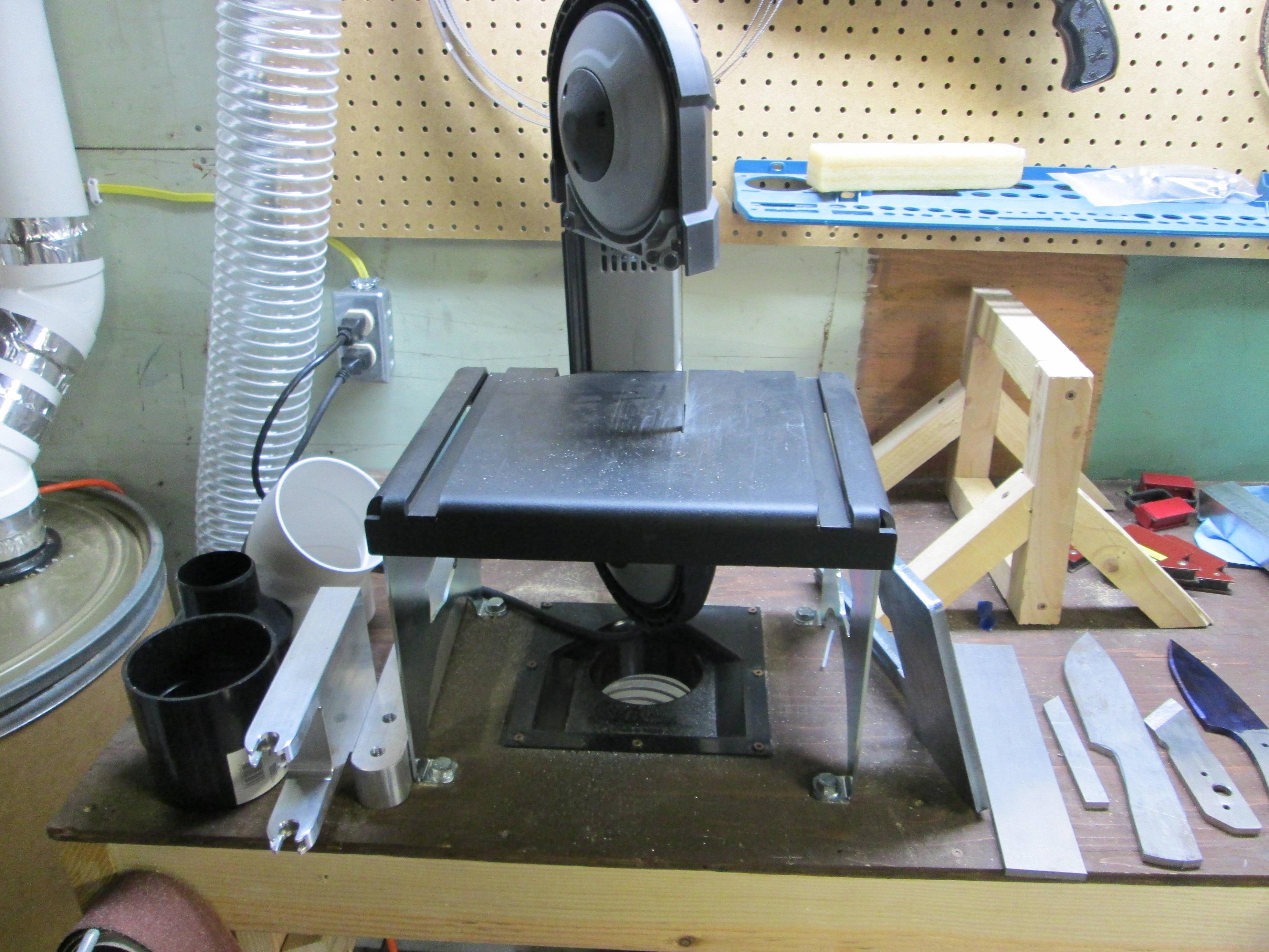

Right now, I cut out my blanks with an angle grinder, hacksaw, bench grinder and shape with a belt sander. I'm considering trying a power band saw. How do you do it and does anyone have experience and suggestions on using a band saw? Suggestions on type of band saw?

I use a portaband that is mounted in a table.
I have only made 5 knives i use a plasma cutter (i make my knives at my works metal shop) we also have a band saw with a blade for sstainless i havnt tried saw yet but im wonderimg if saw would be better since im not very good with plasma
I use a HF metal band saw. Just use a good bi-metal blade, like a Lennox. It will save lots of time and frustration.
vertical metal-cutting bandsaw mostly.
HF portaband in a homemade stand here. I attached a piece of plywood to the existing "table" on the saw. I can take some pics when I get back home if anybody wants to see it.
I too use a portaband saw. One thing to consider if going this route is the configuration of the blade. I have a Milwaukee 6232-21 and the blade is positioned in a way that I only have a 5" cutting depth. This has not caused any great problems yet but I am making relatively small knifes ( 10" OAL and under ) I have read other brand portaband saws have the blade positioned in a way that would allow cuts of unlimited depth on material up to 5" wide.

I have a Milwaukee Portaband in a SWAG table but I use an angle grinder with a 4.5 inch cutting wheel to make some straight cuts around the profile of my blade and grind the rest away. I have been using a Dewalt angle grinder fr years with no problems. A lot of welders take the guard off their angle grinders which I would not do and i wear a leather apron and full shield mask when cutting. The worst problem I had was stepping on a hot triangle of steel which embedded itself in my shoe. I pried it out and repaired the divot with epoxy. Now i push the hot pieces into a pile with an old broom while I'm cutting. The band saw is slow and I hate changing blades. I am more afraid of my buffer and drill press than the angle grinder. Just my opinion. Larry PS I wear a respirator and earplugs also before someone comments on that. LL
I'm the one guy that doesn't use a bandsaw. We scribe the blanks on a bar, chop them apart at the chopsaw, and then grind to the line with a 36 grit Blaze belt on the 10" wheel. The guy that does this for me can do a blade in 4 minutes, and it comes out clean and ready to scribe edge lines and drill. I get 12 ish knives out of each 36 grit belt. My guy can cut 40 - 50 blades in a half a day. The work sucks, its dirty and you get grit in every crack and crevice of your body.

I bough the HF portaband after reading that so many people like it here but it has sit unused for over a year because it is so much easier and quicker for me to cut it like Andy described
Chop saw then grind to profile, as Andy mentioned it only takes a few minutes.

For my blanks I either just do them straight on the grinder with a slightly worn 36 grit blaze belt, or I rough them out with the bandsaw and then finish the profiles on the grinder. For my next batch though I am having all the blanks waterjet cut. I can do the exterior profile pretty quick, but getting the skeletonizing on the tang right takes a bunch of time on my manual milling machine, so waterjet makes sense for me... (But only because I'm doing many of the same profile of blade).

HF portable variable speed band saw with Morse bi-metallic blades. And this will be one of the rare times I disagree with Strigamort. Since you can almost always pick up one of the portabands for well below $100 (when using the HF coupon), I'd say it is worth it even if you only make less than a dozen knives a year. I'd say that number about aligns with my hobby habit, and I would not be without the saw now.
