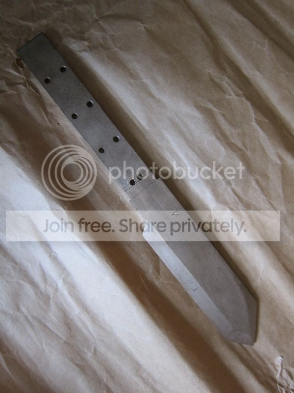

This is the blade.
How thick is the blade?
and why are your bevels so low?
I would full flat grind
It's such a fat angle.
I don't understand this popularity to put a scandi grind on everything
Think razor blades, not splitting maul.
3,5mm whit an edge angle of 22 degrees or something. I like this geometry because the way i strop the knife they get to a steady state. By steady state i mean that the stropping forms a semi convex edge that i don't have to touch up. Shaved my self whit a knife whit ARNE steel from the same company that made this AEB-L steel and about that angle and geometry yesterday actually. I was touch up 6 month ago and it is my go to knife so its had about 20 15 minutes stropping sessions since. But the reason why this knife looks so brut is that its a tool knife not a hunting-knife. Full flat grinds looks better but I have yet to master them.
And tanks when I mean thanks, and god for good, and fore for for. I hope its not to annoying. I try to watch my language. Thanks for telling me. Full flats or at least higher bevels is definitely the next step.
