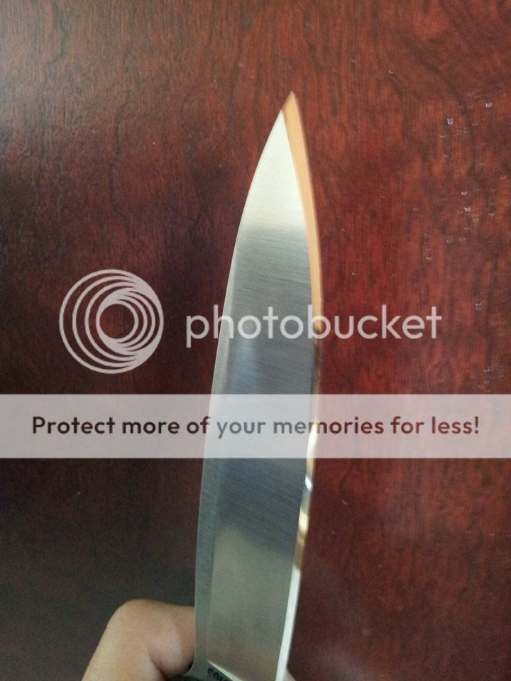

I'm just curious what grit everyone takes their blades to and what angles they prefer. The reason I ask is because I'm currently tinkering with a few different steels trying to figure out what grit level I want before I start stropping. My CPM-D2 like a good 800 grit edge because it's still fairly toothy and will splice hair but won't suffer micro damage from plastics and thick cardboards like a 2000 grit edge will. However I'm not sure how to finish my CPM-154 blur and my ZDP-189 endura. Should I go super mirror polished or is a lower grit/toothier edge more efficient and aggressive for these steels?

I like to use 0.5 micron right after a 1k stone, it gives the bevel the attractive polish but keeps a little bit of "toothiness" right at the edge.
It's a good balance for me. It's sharp, it's fairly attractive (in my opinion at least :D) and it doesn't take much time at all.
Sorry for this last blurry picture, my hands are a little jittery this morning :o
OT - I see 1K grind scratches go toward the apex. But there is slightly bent bacon strip at the apex (fold/creases perpendicular to the grind scratches) could be a bend-wire. Or maybe the pic tricked my morning blurry eyes.
Ooops, that's the wrong picture :o I think those "folds" are the scratches from the DMT XC stone that haven't been completely taken out by the 1k stone yet. I should really start labeling the microscope pictures...
EDIT: Actually, on closer inspection I think your initial thought was right. I took a look at some other pictures from the same time, and found similar bent regions on some of the thinner edges. I believe this was from when I was learning to strop :rolleyes:
