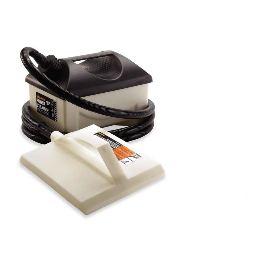

If it makes steam it should work. I use a wall paper steamer for my sharp bends. I connect the hose to a steam box. 30 minutes later and it bends like butter.

Heat/steam is the way to go. Steaming is easy and it works. Just use a wide roasting pan on the stove and seal it up with wide heady duty foil. Half an inch of water is all you need. 20 minutes once it reaches steaming will do it. As Osage Orange said bend it only slightly past straight. It will only rebound a little. I clamp mine to my cast iron table saw top.
