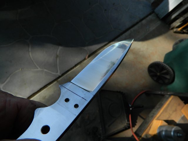

OK Brett, I am going to install some glass on my KMG stock platen. ( I will have man pants then!) Where should I buy the tape? Here are a couple photos of the blade I ground this afternoon. I finished the grind to 1200 grit on the 8 inch wheel and the flats to 600 grit on a 9" disc. After heat treat I will go through the finer grits again and grind down the 0.40 edge I left. This has taken all afternoon because I started to let the flat platen grind the one side not quite parallel so I went back to the 9 inch disc and went through all the grits to get it flat on the ricasso and the area above the grind. I will try the glass platen next. Thanks, Larry PS Do I need to install a ledge for the glass to sit on?
