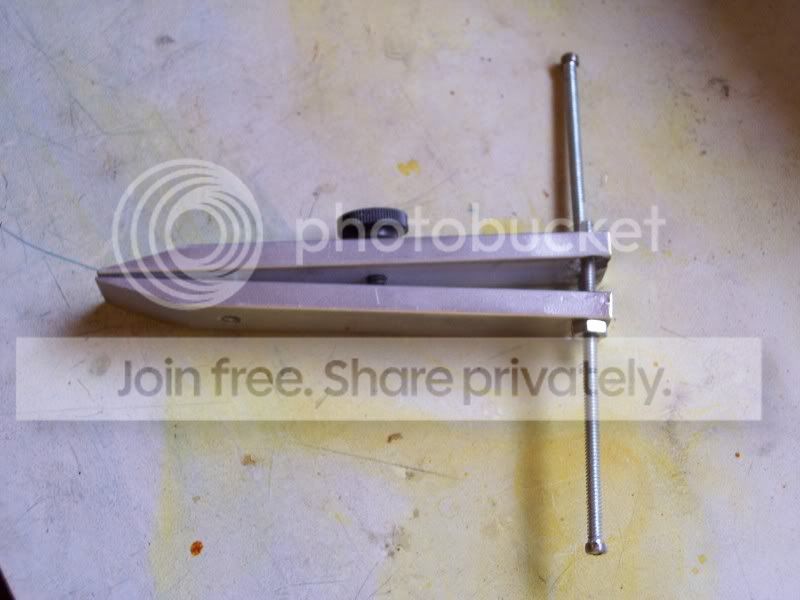

Here is the fixture that I use on my Bader Blll to sharpen my knives, that rayban ask for.
The first one is the blade clamp

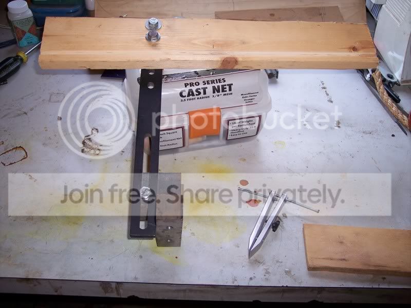

the next one is the jig for the grinder

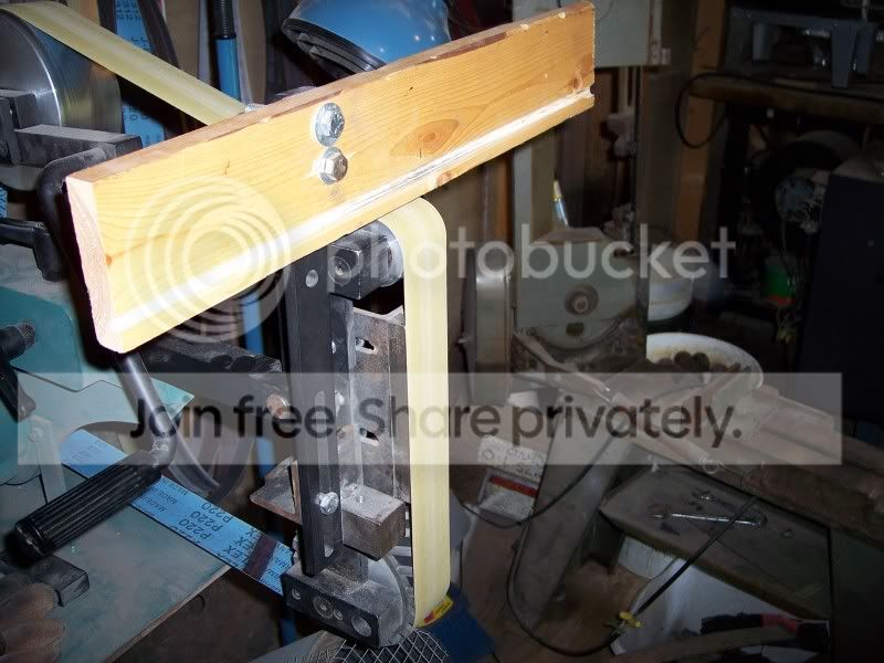

the next shot shows the jig bolted to the combination arm, where the tool rest bolts on

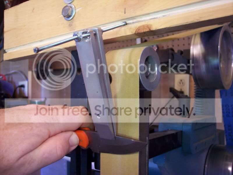

the next shot is with a knife in the clamp and held in position to sharpen. You can adjust the angle by ajusting the two all thread bolts in or out. I use an angle finder held on the blade to determine the angle of the secondary bevel.
I use a combination arm instead of the platen arm, but it should bolt up very similar.
The clamp would be easy to make if you have a milling machine, could even be made by grinding. The board at the top has a groove cut in it for the rods to slide in as a guide, and the board is setting about a 1/2" behind the belt, looking at it from the side. I hope this is clear enough to understand, if not I will try to explain it better if you email or PM me here.
