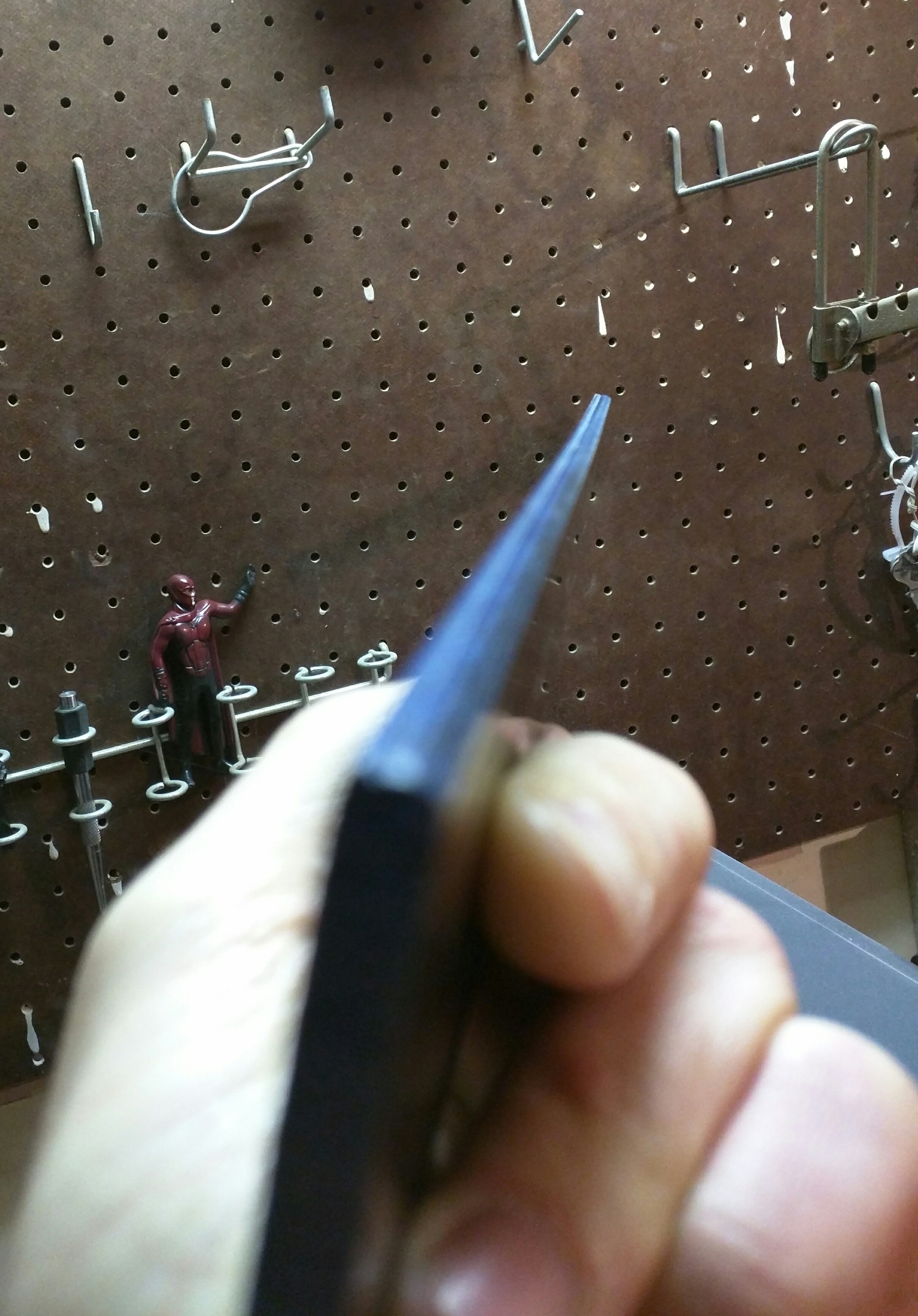

After spending another late evening in the shop, I still feel like I'm missing something about this whole bevel grinding business. To date, I've ground 5 Kiridashis, 1 smaller fixed blade, and my thumb twice.:o:thumbup:
In an effort to keep my bevels looking as clean and straight as possible, I've essentially just been holding the Kiridashi stationary against the platten at the desired angle. I hold them edge up, with the actual cutting edge parallel to my tool rest. I hold them pretty firmly for several seconds, and dunk them when they get warm to avoid ruining my heat treat.
Does that sound right, or do you guys do something differently? I'm using a Grizzly 2x72 and the cutting edge of the Kiridashis are short enough to fit entirely on the belt at once.

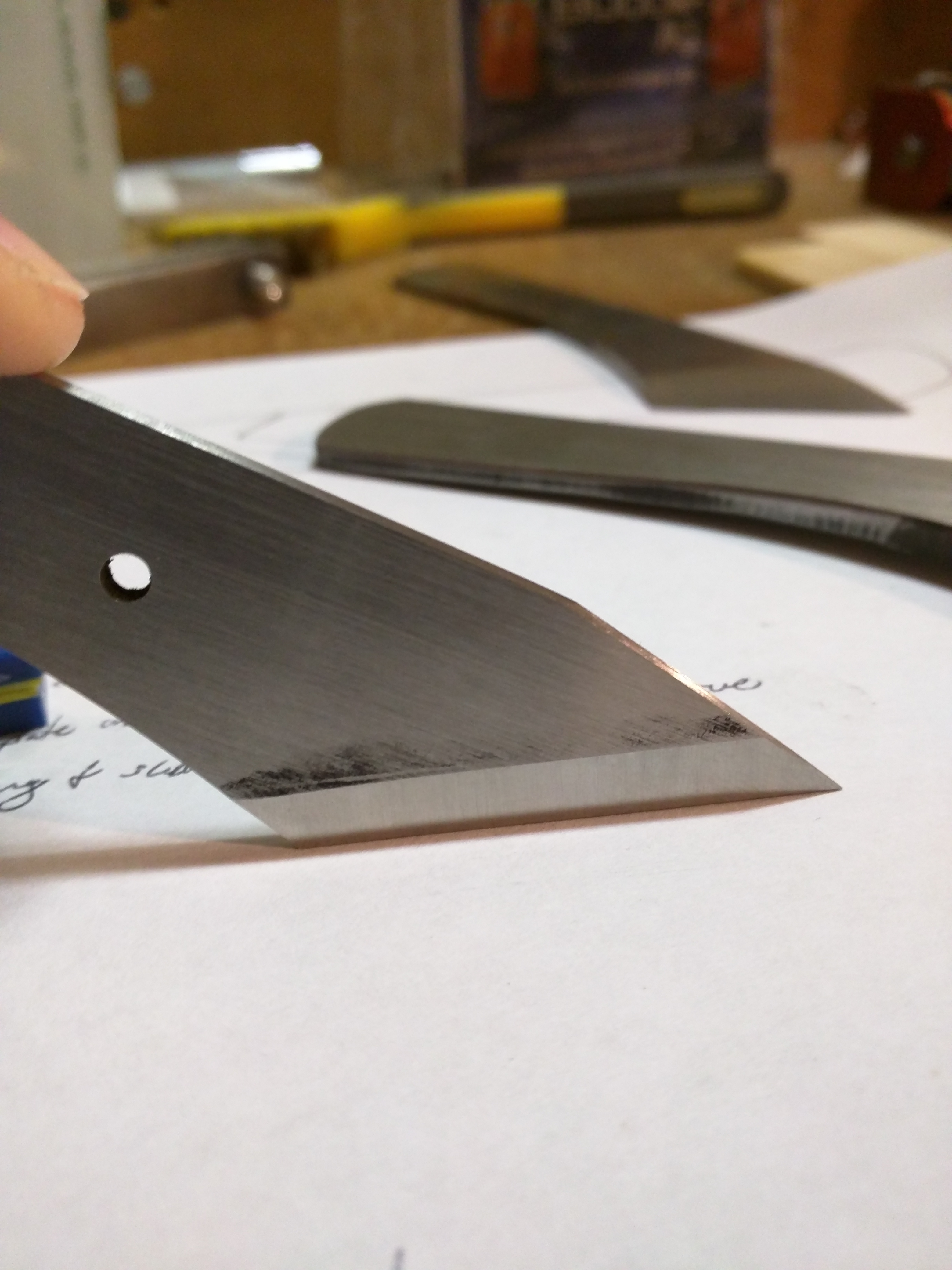

My apologies, I tend to ramble without explaining the important stuff! The actual edge of the first few Kiridashis I did have a slight curve to them, a tiny bit of belly. They are right-hand chisel grinds with no secondary bevel. I had ground the edge flat against the platten when profiling the blade prior to beveling, so I had assumed my edge would be straight and was surprised when it wasn't.
My bevels are starting to look more and more even with each blade that I do, I was mostly just curious as to whether or not my technique needed any tweaking. I know on longer blades starting at the plunge and drawing toward the tip is how bevels are formed, but I couldn't really find much information for beveling Kiridashis.

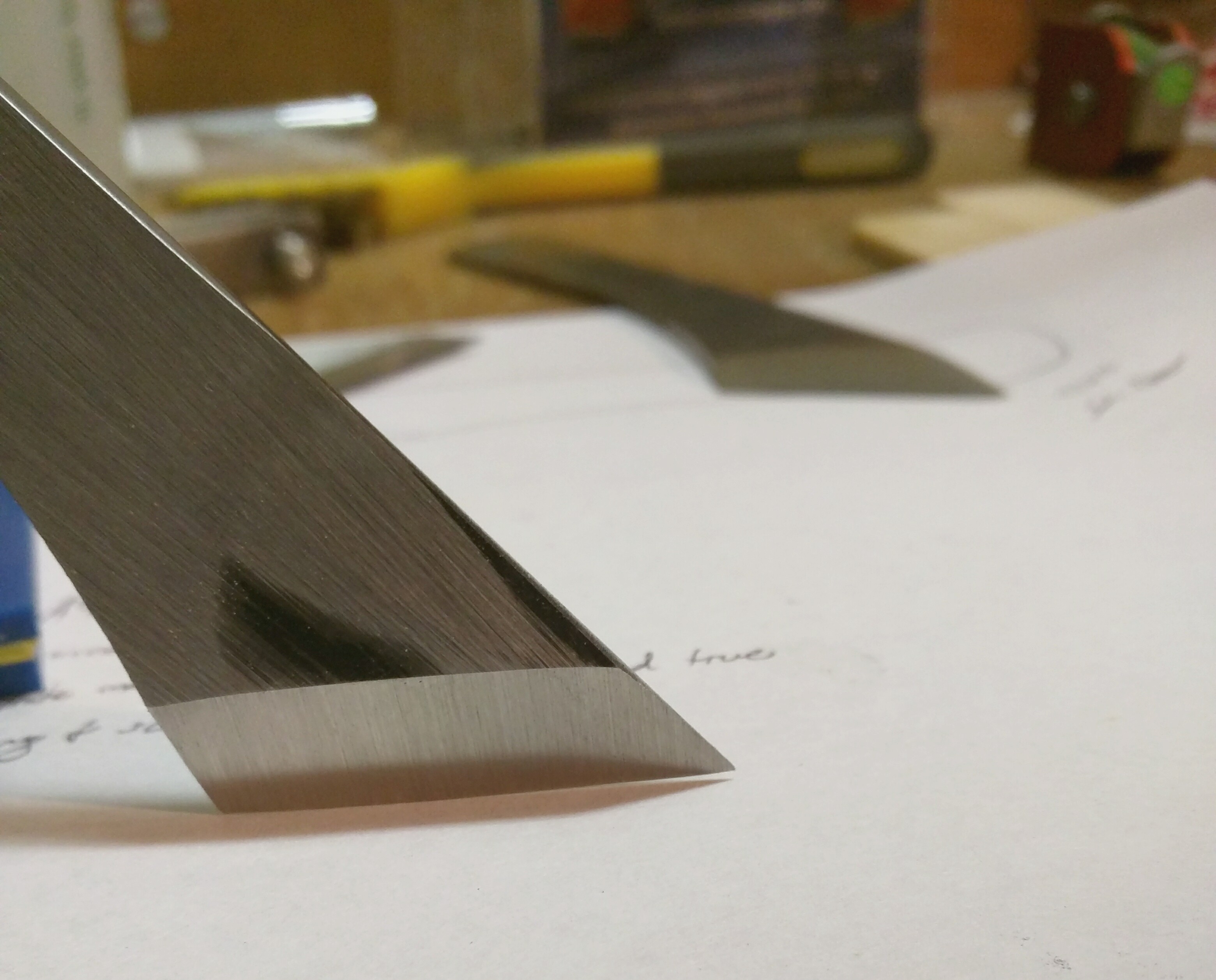

I believe you are both right. I'm generally using a slightly used 60 grit norton ceramic belt to cut my bevels, and I have checked my platten for flatness as well, so it really had me stumped until I got to looking at the piece of 1095 I had cut the first few knives from...
It's a lot more obvious in person, and I have no idea why I didn't check this from the get go. Live and learn! Thanks for the suggestions guys! On a related note, I won't be buying hot rolled 1095 for the foreseeable future, as I've learned it is less than optimal for the setup I've got currently.

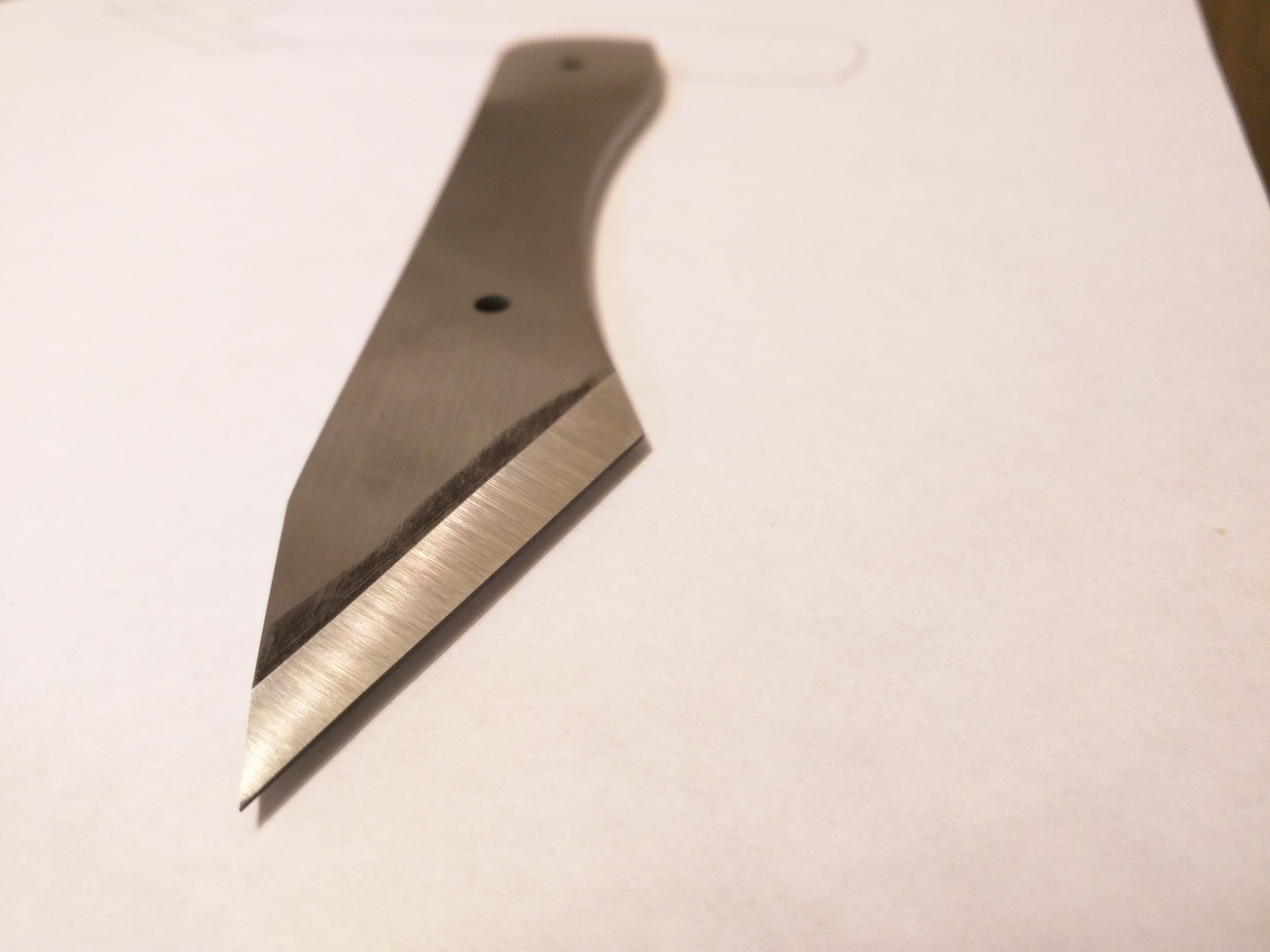

I've still got a bit of grinding to do on this one (edge is 0.023, needs to be a touch thinner before sharpening) but I think the double bevel turned out nice!

I've made that mistake recently as well, the first Kiridashi I did out of 1/8" stock ended up as a convex bevel and I ordered a bubble jig from Fred the same night. :D Since I've received it and started working with straighter stock, my grinds have been improving.
I didn't do a very good job of explaining what I meant, though. The problem I was having before (due in part to bent steel) was that the edge itself wasn't flat, like it should have been. If you look at the tip, you can see it.
But after working with actual straight stock, I was able to get an edge that is totally straight!
