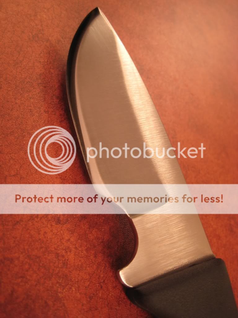

You can get a "Mirror" edge on any knife with any different method. I just comes down to having proper abrasive grits. The most time efficient way (regardless of method/technique) is going to be to use stages of finer and finer grits. If you do it by hand, using staged grits is even more important because each consecutive grit has to remove the scratches from the previous grit. If you skip too far ahead in grits, a grit that is too fine will have a VERY hard time removing the deeper scratches.
By hand, this can take hours.
With a belt sander - minutes.
The following knife was sharpened entirely with a belt sander (cleaned up, satin finished, profiled, etc. all with belt sander) and it was done entirely with two belts - 80 & 120 grit (** Cheater tip - the back mesh side of 120 grit with compound was used as 3rd "grit" option, but still 2 belts. ;)). Anyway the results are good/decent - WAY better than factory. That blade will easily push cut through newspaper or magazine pages. Shaving is smooth. :thumbup:
With proper belts and grits, it can be done way more efficiently and even more mirror finish.:

I really appreciate all the info. The reason why I wanted to know what type of edge the BAD has is to keep things simple. I do prefer a convex edge, but in the interests of simplicity I was just going to go with whatever the BAD has and not deal with any reprofiling.
Looking at the knife, as you said, the edge does look to have a degree of convexing to it. As such I'm probably going to stick with sand paper and a strop. I do like the sharpmaker and stones for my daily carry knives because they are simple and quick. However since this is my first Busse and isn't going to be an EDC I'd like to get it "wicked" sharp and don't mind sacrificing a little speed for an extra sharp edge.
DWRW, I havn't seen much convexing on Busse's in nearly two years untill some recent ones this year.

Ken, I am not trying to step on your toes or question your knowledge. Maybe yours are flat (?????).
But, from what I can tell, most of the many Busse knives I have (and have had in the past) clearly appear to be "slightly" convexed and appear to have been sharpened on belt sanders. It doesn't appear they put too much time or effort into sharpening or even fine grits (probably 80 grit or so on most and maybe 120 on Competion edges ?????), but I would bet belt sanders anyway.
It is possible that some could be "possibly" flat ground while others are convex. "Some" belt sander have or can be fitted with a platten to achieve flat grinds. But, for the edges, this seems unlikely to me (????).
Since most Busse edges tend to be very optuse, the sharpened edge is only about 1/16" - 1/8" at most anyway (except for the Competition edges).
With light pressure on a belt, an edge can have a VERY subtle convex and even appear close to flat - especially if the edge is only 1/16" high or so.
Or again, maybe some are flat (?????).
Again, I don't have a Bad. But, from what I can tell, every Busse and kin blade I have has at least a subtle convex.
