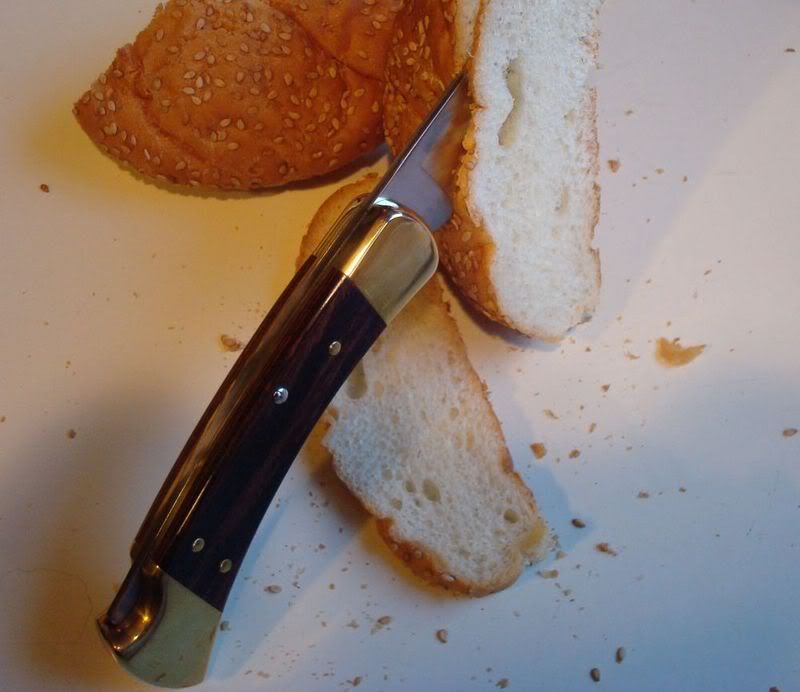

I can get a buck 110 sharp enough to cut paper thin slices of bread, it's one of the sharpest knives I own.
