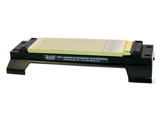

DMT WM8FC-WB 8" DuoSharp Plus Bench Stone with Base, Fine/Coarse
Coarse dotted DMT diamond plate and a thin leather strop with white compound for V-edges, Norton Crystolon for scandi.

I'm going to pick one of those up in addition to the DMT WM8FC-WB 8" DuoSharp Plus Bench Stone with Base, Fine/Coarse
I can purchase both for much less than they generally sell for everywhere.
This arrived today, purchased new on Dweebay for $45.00 free shipping no tax:
