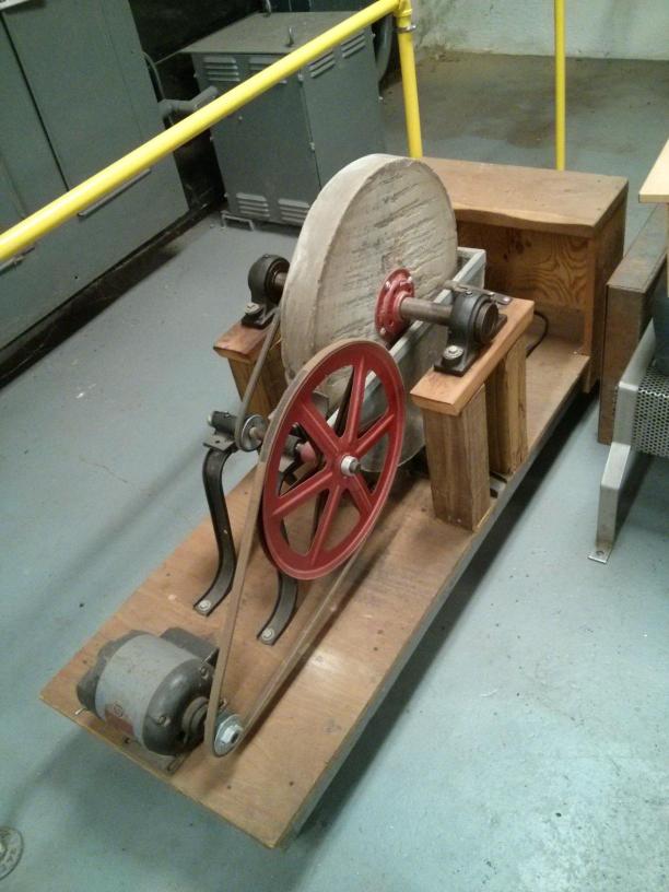

Nice work, TBL, but it's time for me to p0wn this thread:
