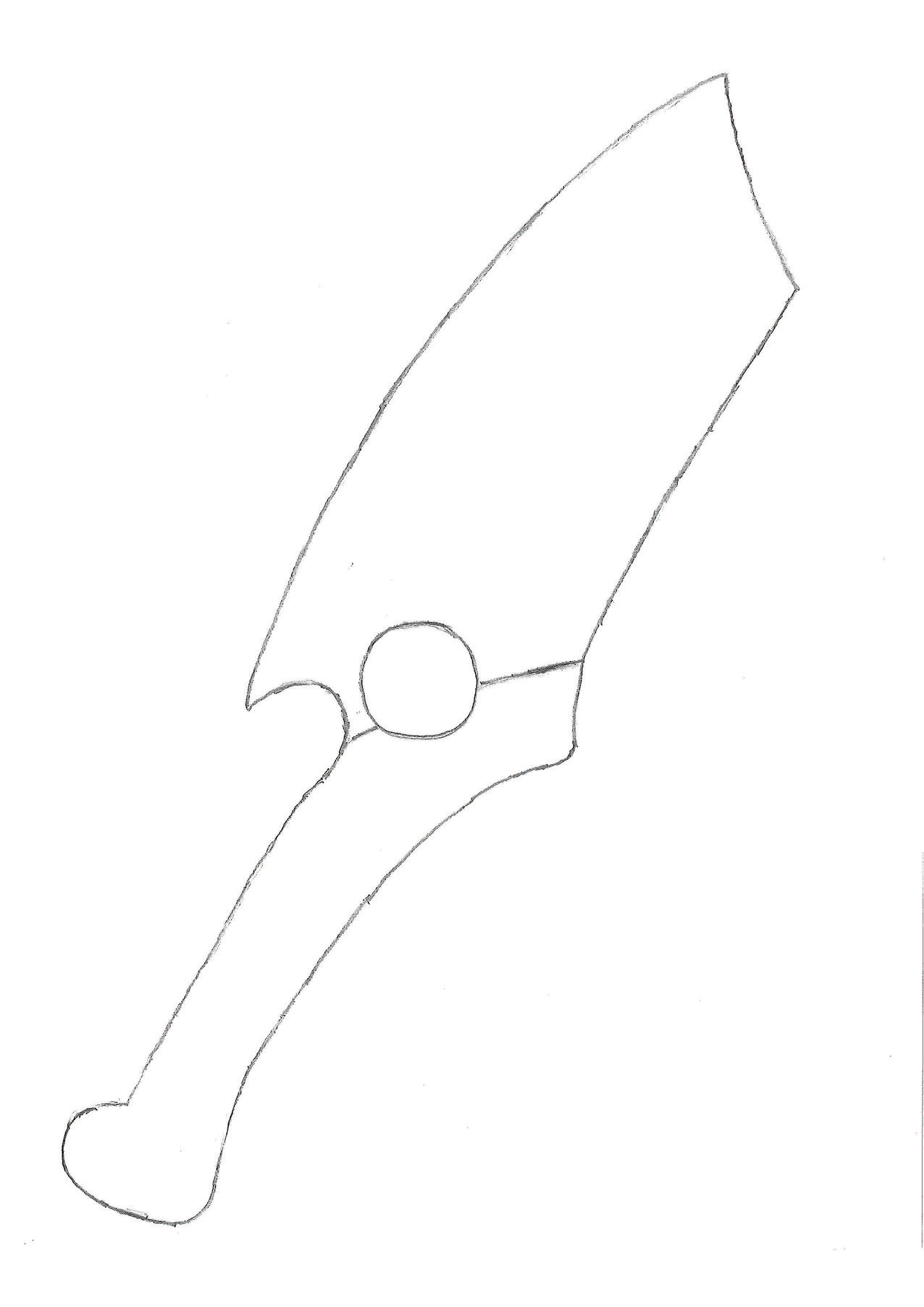

Yeah, I'm not doing that. I am drawing it on paper, trying to imagine different grips, tweaking, and redrawing. I'm trying to base a design on what I think would feel comfortable using my head, but I'm sure it's a lot different than actually holding the finished blade.
This is what I was currently thinking about. It would be 12" from butt to tip. It would be a chopper but the hole in the blade face and the spine's shape hopefully would allow you to choke up a bit and do some detail work.

I make blade profiles out of acrylic sheet first. They are very easy to form and can be used as a template if you decide to make it again. This allows you to hold the blade in your hand and judge the size and basic grip. You can then mold some clay or play-dough around the tang to see what it could feel like with some handle material on it.
For a bigger blade as you drew above, I'd shape it out of 1/8" plastic first. You can get it at home depot/Lowes by the windows or online at a place like US Plastics.
The only problem i see is with the handle. A good knife starts with a comfortable handle or grip. First look at your palm is it convex or concave your handle would be perfect for a convex palm but not a normal palm i dont think you would use this knife much after the initial testing of it. Make the handle straight or curve it the other way. Please dont think that i am being rude. Just trying to save an other wise great design! :)
Not rude at all. Thanks for the help chad.
Thanks for the help from everyone else too. I made the point below the hole a little less pronounced, tweaked the handle, and modified the rest a little bit. Currently on cardboard rendition #5. Just have to try it with something a little more substantial then I think I'll actually try to make the blade!

The reverse curve in the handle does not adapt well to a human hand.

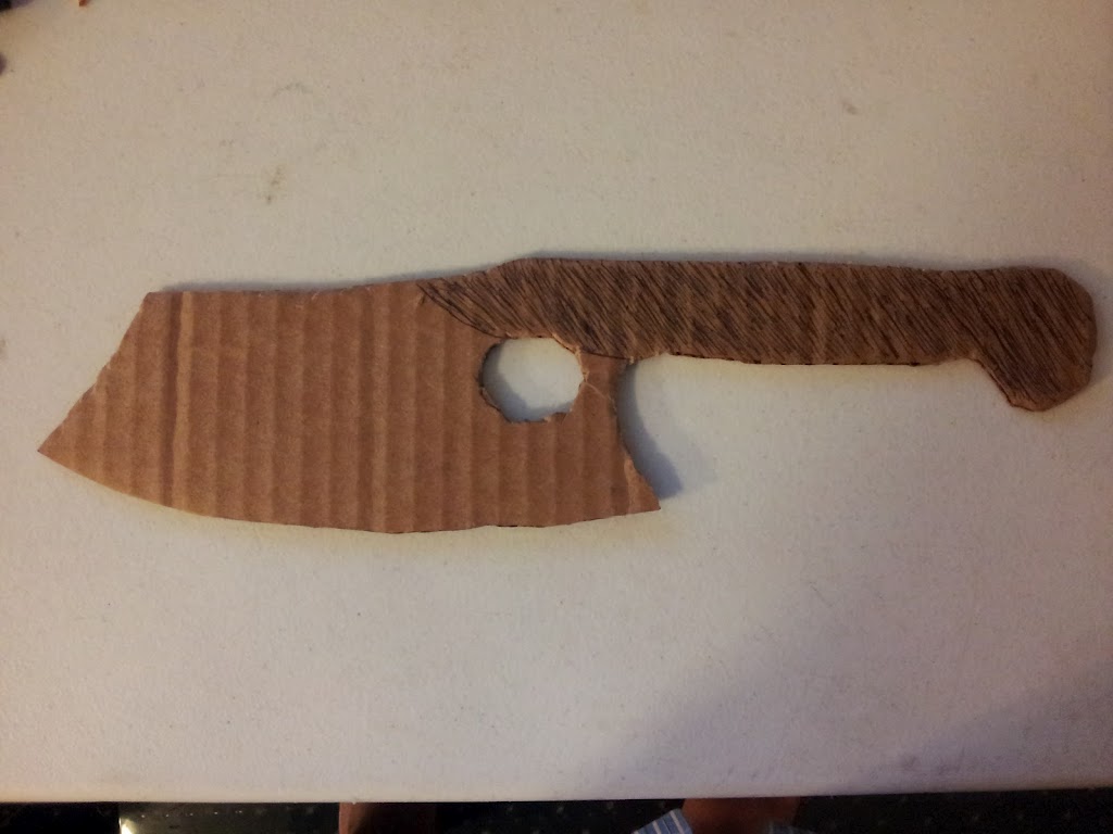

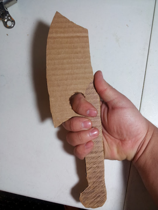

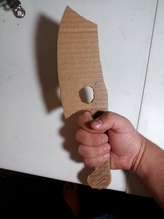

Quick shot of the cardboard cutout on my desk.
Feels pretty good in the hand. I figure I should probably try to attach something to the sides of the cardboard tang to see how well it would feel with a handle. I like the hole which lets me choke up on the knife when I want to cut something with the tip or do some detail work.
Edit: added a few pictures with the mock-up in hand.
