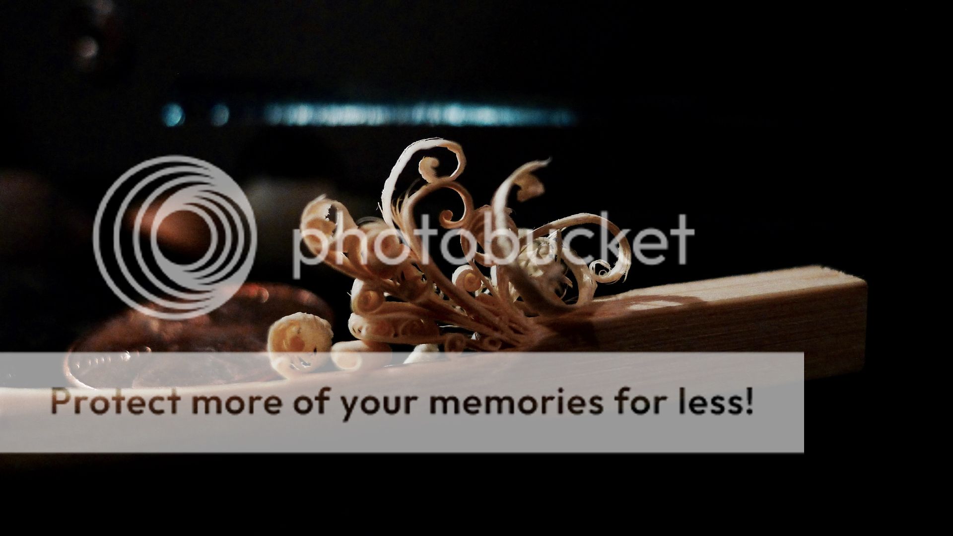

Like the title says, I'm wondering what techniques/methods you guys are using to test sharpness.
I find cutting paper too easy: just about any knife can do it. Shaving hair off your arm? That's nice...but I'm not crazy about walking around with bald spots on my arms like a mangy dog.
Lately, I've been doing the fingernail stick test, followed by shaving some wood. I'll make little mini fuzz sticks on chopsticks or even toothpicks. Here's an example using one of my Dozier folders on the end of a bamboo chopstick:

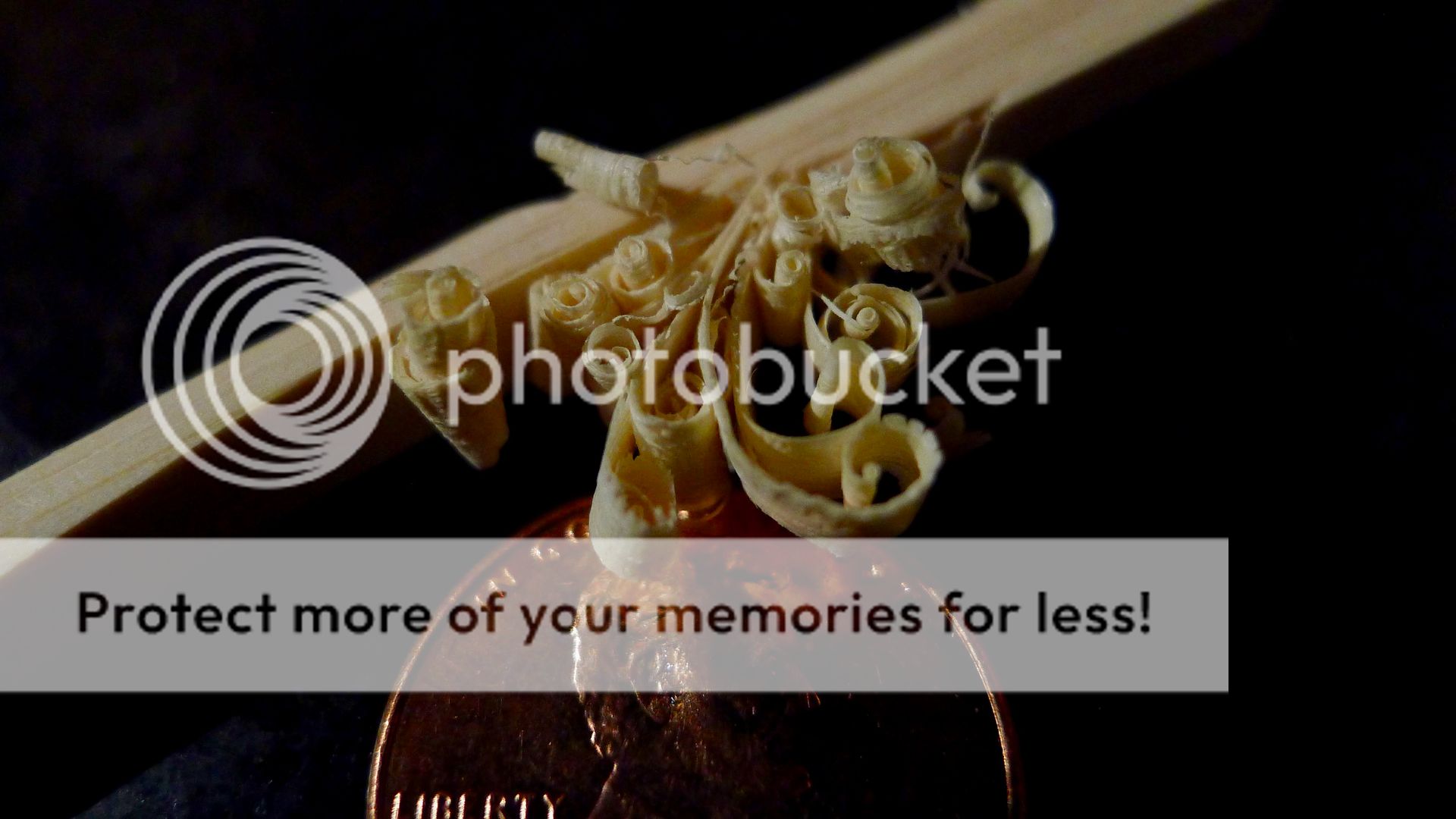

Those are some pretty tight curls for such a big knife. Penny for scale:
This is actually harder than it looks. Bamboo is fibrous and inconsistent. Very easy to splinter, break, or hack off a chunk. If I can cut really fine, smooth curls with ease on a brittle bamboo chopstick or toothpick, then I know I'm good.
How about you?
