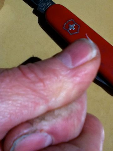

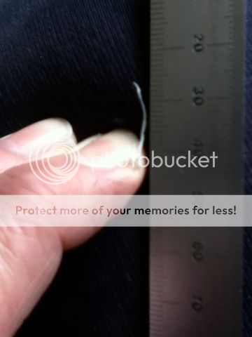

I thought of the other test I do. I test the edge by carving chips off my finger nails. When it is sharp AND THE GEOMETRY IS RIGHT it takes a controlled chip . . . when I have the edge geometry the way I like it I can take a longish curl like off my thumb nail here
and when I got 'er cranked down and dialed into "Oh My Bob That is AWESOME !" this is what happens with out too much effort.
When I don't quite "have it" all I get is minuscule little chips that pop off before I want them to.
Careful ! When it is cutting curls it will take off skin off of your finger tip and you won't feel it.
