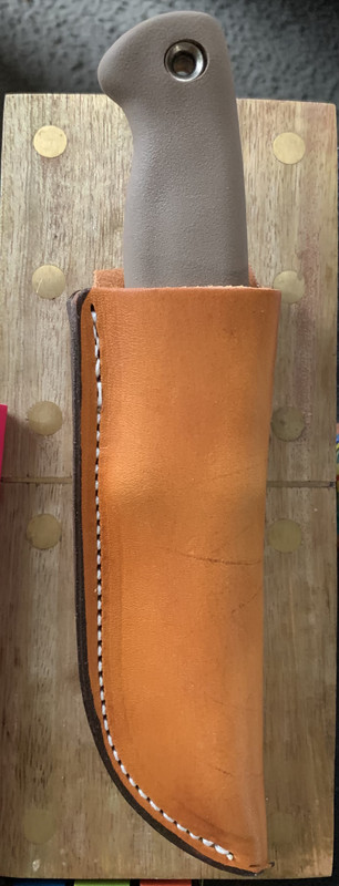

I just got a leather sheath for my SYKCO 311. The knife fits good, but the draw is tight. What’s the best way to loosen it up a little?
Hmmmm my first thought would wet mold it ? Warm water ( I’ve heard some mention a drop of dawn dish soap ) soak up to where handle will stop. Soak like 20sec try it , maybe another 10-20sec soak try it. You don’t want to water log the leather. Once it’s fitting let it dry with knife in it. You could plastic wrap the knife before inserting.

I don't disagree that wet molding could provide a better fit. I do it on most of the sheaths I make to ensure the retention and removal effort is correct. However, there are two risks with the process in this situation. First, the sheath most likely has some type of finish on it and some makers put it on the inside and outside. That could make it difficult to get to the right moisture content and/or result in a damaged finish that can look pretty bad. The second risk is that even if the sheath can be properly prepared with water, it does take some practice and skill to get a good fit. It is highly possible to get it too loose and have a different problem.
I would suggest the first thing to try is to get some pliers or a hammer handle that can be used to insert into the sheath force the leather to expand some in the areas where it is tight. From the pictures, I can clearly see bulges where the guard is probably located. I would start at the top and work down to that area with whatever tool you have, carefully pushing out on the leather to ease the fit some. It might take a few try's but it will loosen with effort. The thicker the leather the more effort needed but the risk of damage or creation of a different problem is very low.

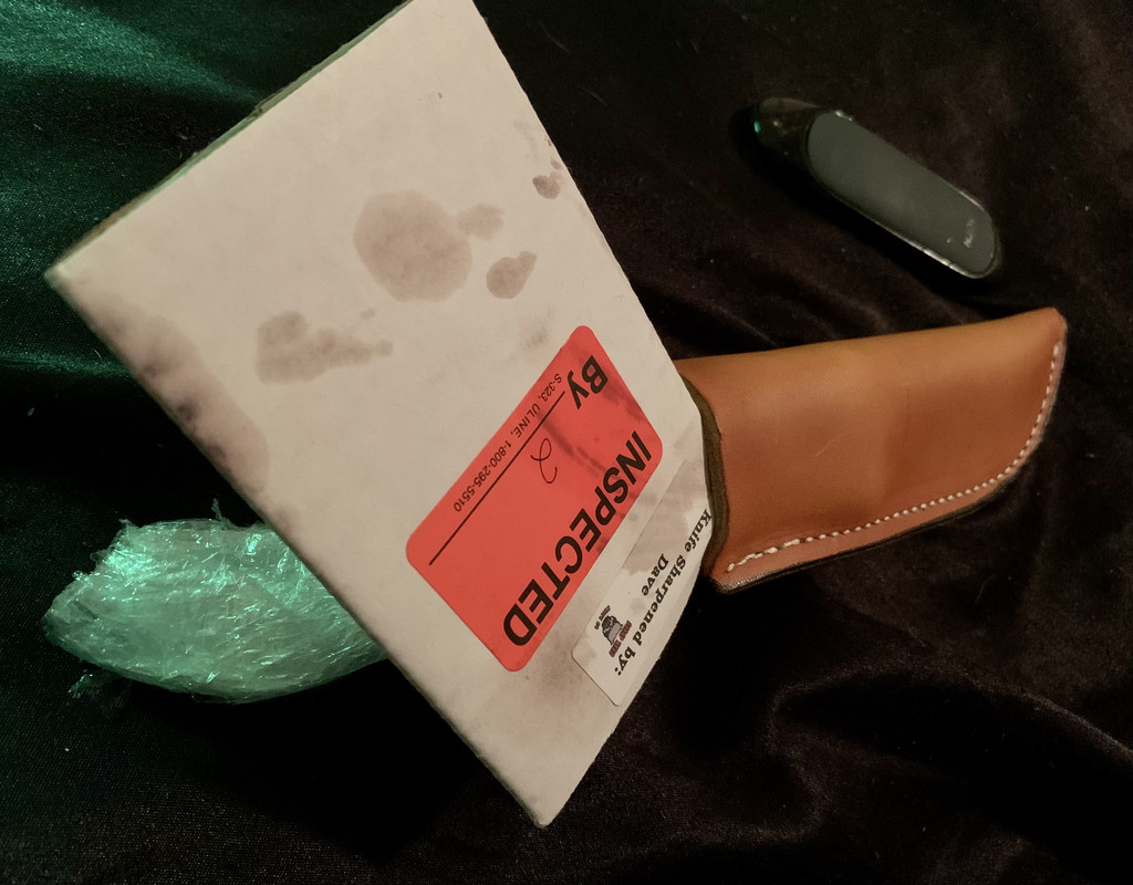

Thank you all for the suggestions. I wound up wrapping the knife a bunch of times with plastic wrap, wet the sheath down a little, and put the knife in there until it dried. I put a little cardboard at the opening to flare it out a little.
After it was completely dry I treated it with leather conditioner. Fits like it was custom made for the knife now. It’s still pretty tight, just not ridiculously so. Has a nice “set” when it’s in all the way and draws nice.
