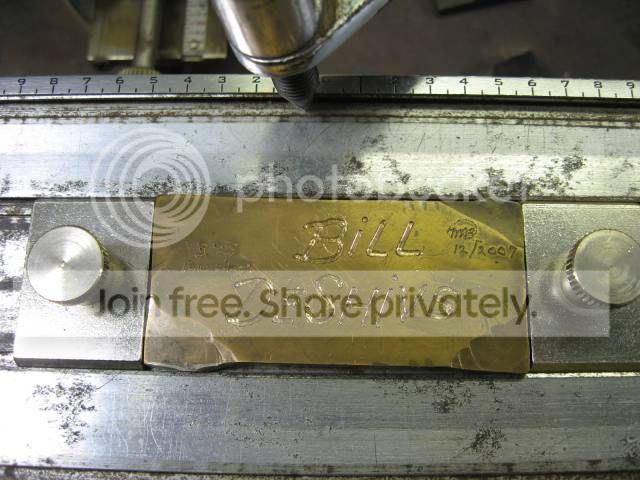

The New Hermes machines are pantograph engravers. Type is available in many fonts, and you can adjust the engraving size. They are great for flat objects. I'll try to get a pic of mine tomorrow. I have 3 of them.

Great pictures Bill, thanks. How did you come up with your template, I saw you had mentioned you are a hand engraver also, did you simply make it yourself? How would you go about a 'stylelized' logo for example? I appreciate all the feedback, anyone have info on Lasers? I'm assuming they're pricey...
Draw/write it on a engraving plate blank ( or make a blank from brass) and cut the pattern in with a carbide ball burr.
If you have a CNC mill, you can cut the plate from a CAD.
I scanned my written signature into a computer and traced it with NURBS in a CAD program and used that as a path for a small ball endmill in a CNC mill. I varied the depth of cut a little to simulate the natural variations in width in the handwritten signature. This probably isn't the simplest way to do it, but it's reliable and it looks nice. That's my milled signature in my avatar.
