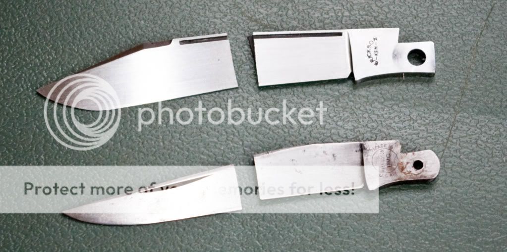

Some of these modern steels will snap (break!). I would crink carbon steel, but leave it to the maker to crink ats-34, bg-42, even d-2. I watched a nice looking bg-42 blade shatter into 3 pieces with a light tap, on Queen's repair bench! They gave me a new knife, fortunately!!

BG-42, I've been told by an expert, risks snapping every time.
I learned my lesson the hard way (sigh) to leave expensive knives to experts, and bang away on the cheap ones.:rolleyes:

works pretty well while not the whole answer. Ats-34 Rc61-62 after the draw and the obvious 3
point setup, some use arbor presses. The overbent blade in the vise, and the blade after. Have
only ever broke 1 blade doing this and I knew I was way over. I've broke test blades on purpose
both ground and unground and it will surprise you just what they will take. Somewhat of an overbend
is necessary so when they come back they stay where they belong.
