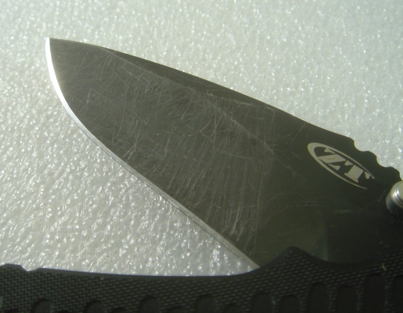

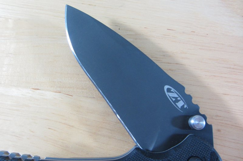

I use a metal polish called Nevr-Dull. It cleaned up my 0550BLK nicely.
Before:
After:
