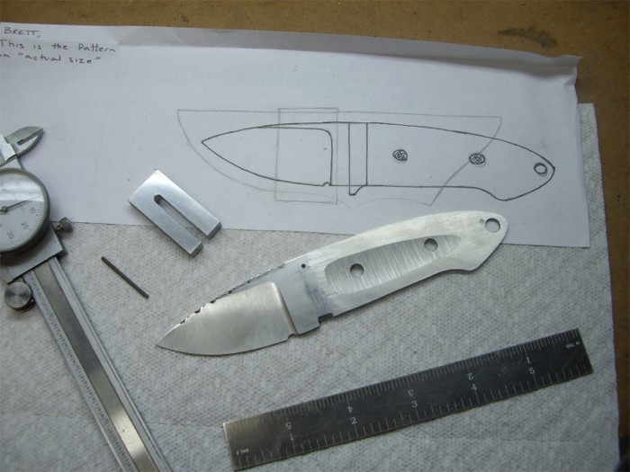

you'll notice on a lot of the tutorial/WIP threads that a lot of makers hollow grind the center of tangs in the rough grinding stage (after drilling pin holes) - being careful to stay away from the edges of the tang.
This makes it much easier to taper and finish the tang, since you are only dealing with the edges.
If you do it like Mark said you will have a lot less sanding to do because you are only sanding the thin edge around the outside.

I drill a lot of holes through the tang, to both lighten the weight, and allow the epoxy to make bridges between the scales, then flatten on a 6x48 table sander to 100 grit. The tang and ricasso are treated as one in this. The table sander will make the tang and ricasso dead flat if held on the sander lengthwise. I then go back and true up my plunge line, if the blade has one.

I've done it on my craftsman's drive wheel. I had to cut off some of the factory guard towards the bottom to reveal more wheel but then it worked like a charm. Just be careful that you don't get the blade stuck in between the wheel and the guard. If you take off some of the bottom of that guard it will also help in not having sparks come all the way back around the belt and hit you in the face. Once I did this, I actually grind the hollow into the tang all the way down the tang all the way to the end. You'll end up having two hollows on each side and it allows you to see where you need to taper to. Of course, this is only if you want to taper the tang otherwise don't take the hollow grinds past the end. Just hollow out the middle between the pin holes.

I also use an 8" wheel to grind the hollow. Here's what's left of the hollow after the tang has been tapered - there was a lot more to it before tapering. By the way, I grind the hollow even if I'm not tapering the tang - that much less flat to finish. Of course, I don't take it off the end of the tang in that case.
Yeah, just like Mr Schaller said. I didn't get a chance to grind the hollows on this blade but here are some pics showing the main idea.
this is where the hollow will go...you'd grind a hollow between the two lines all the way to the end
this is kind of what the end looks like when the hollows are cut out
Then, when you grind the tapers in, the two round areas in the butt of the handle area will fade out....like Mr Schaller's pic
