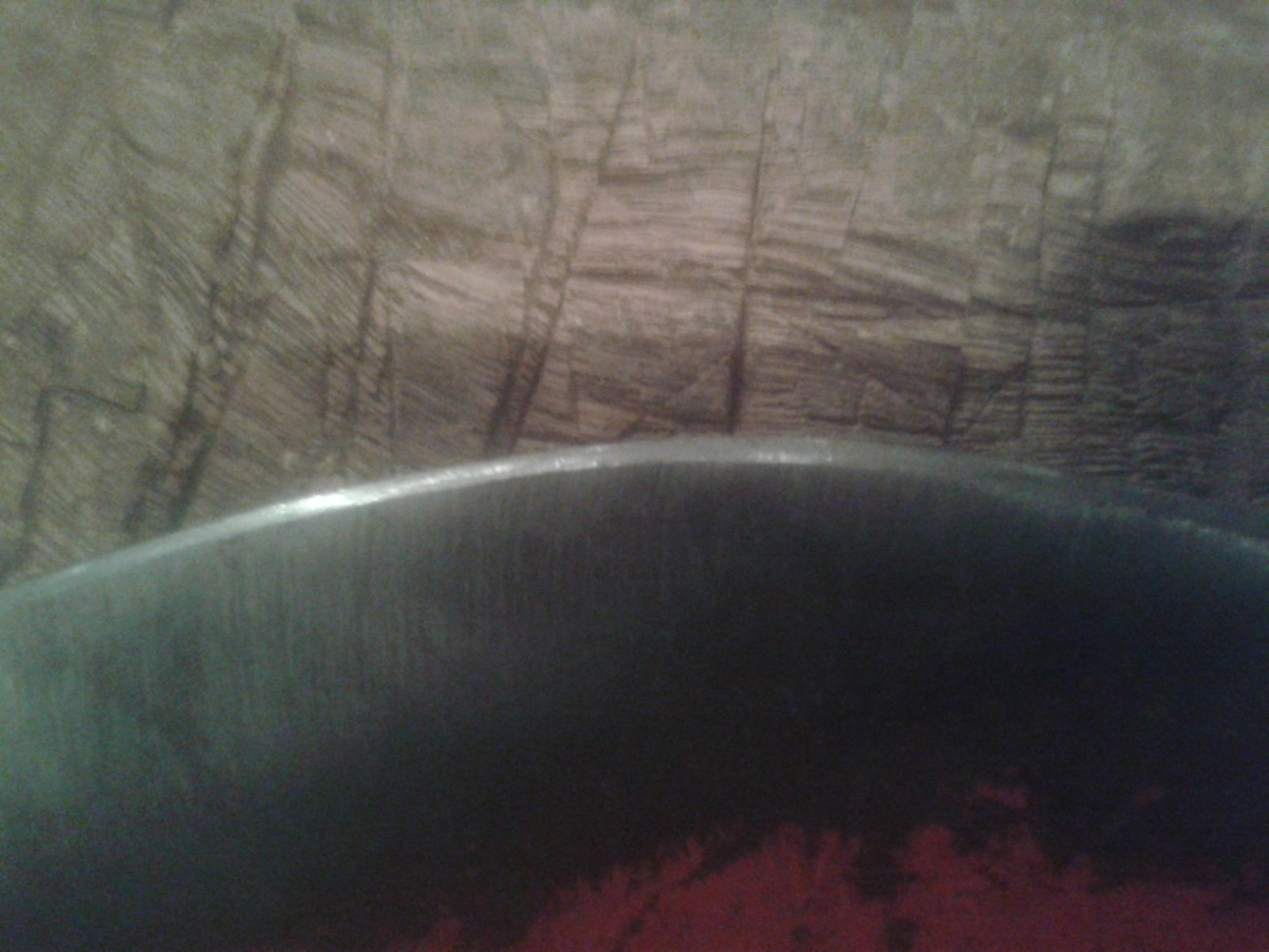

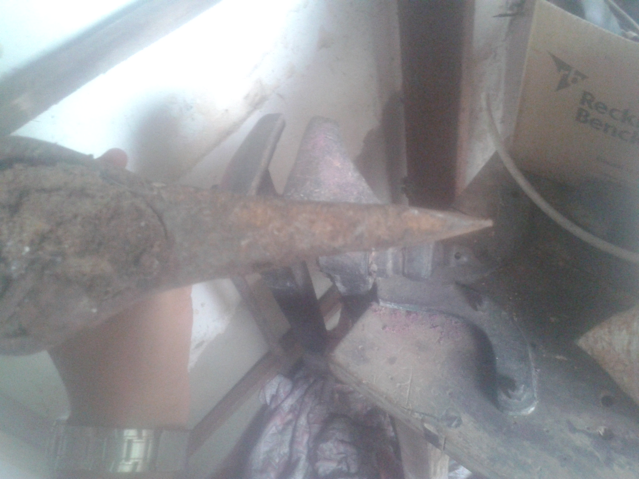

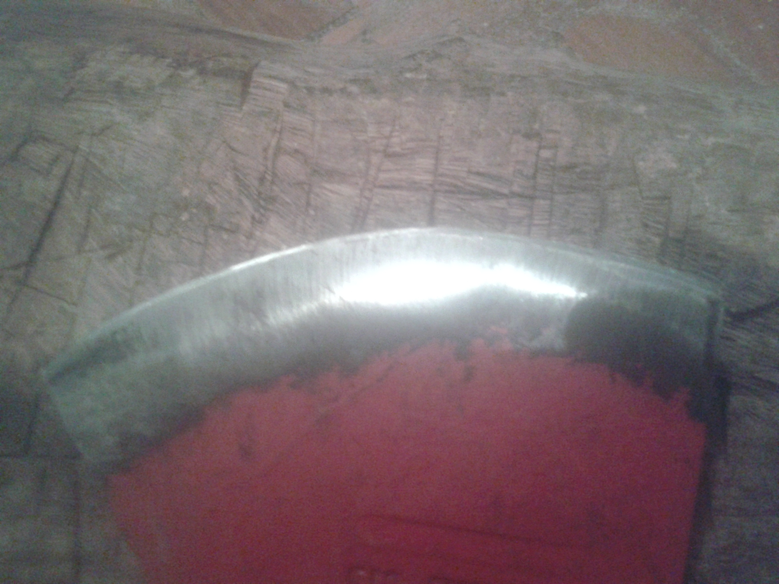

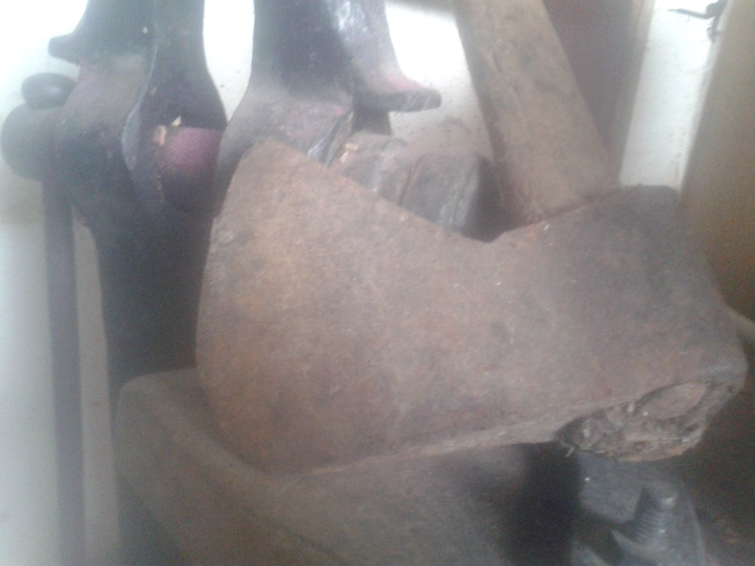

use power tools depends on great skill and intelligence. Our friend there from above seems to have.
I will post pictures of destroyed tools I have at my house. No fault of the electric tool, but an employee who had no skill.
Vou postar fotos de ferramentas destruidas que tenho em minha casa. Não é culpa da ferramenta eletrica, mas o trabalhador que não tinha habilidade.
I can not really see clearly oxide per account.
there are deep moto-grinding marks, the ax lost its geometry, in addition to the cutting angle being so obtuse that are making a new forge to recover this ax.
Congratulations to those who are wise and know how to use high speed tool.
In the case of the photos below is not the case.
A tool killed by a fool.
As the friend "old axeman" value the ancestry of the ax. And I imagine that everyone here tambe because we could be using a chainsaw.
