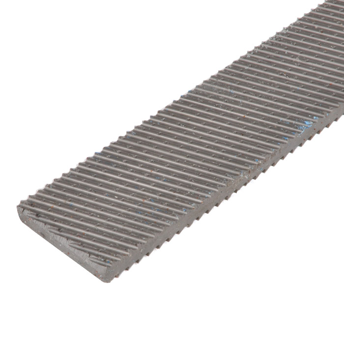

Due to my job I have the opportunity to try a lot of different file types, some weeks ago I found one which has make me not to touch the others in axe concern. It eats the steel very well, taking in account it's a file it eats so much material it sometimes makes you feel you are machining rather than filing the axe. It also leaves a smooth surface, it's perfect for axe needs. I'm far from my tools now, so I will have to share some internet photos, by now. I'm speaking about Pferd's Fitter file,
It has two faces, I start with this side,
Then I turn 90º and I use the side you see in the first photo, use the flat side, turn and repeat till you file as much material as you can. Make last fillings with the curved side. When I finnish using the file I use coarse and fine stone and that's it.

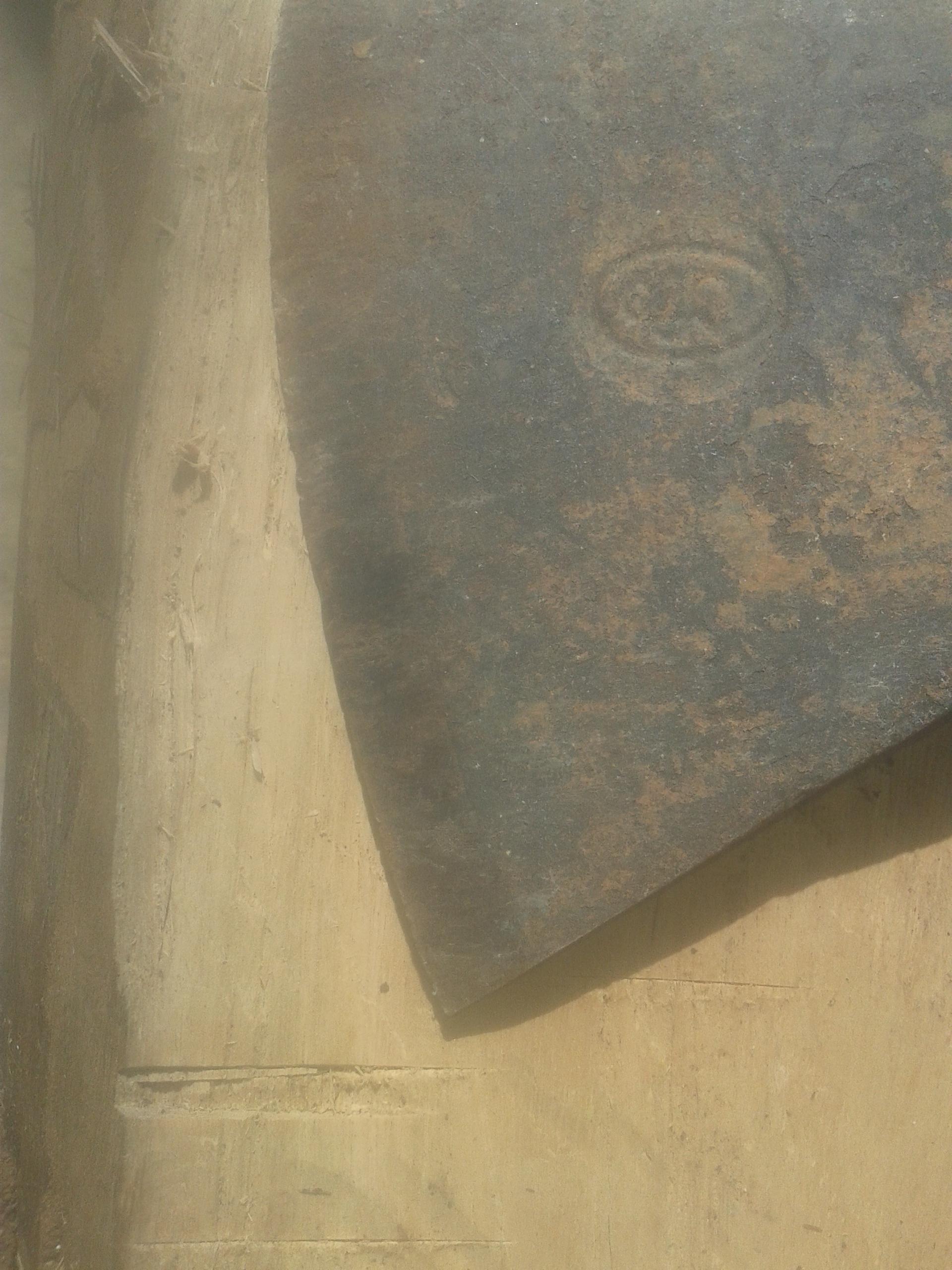

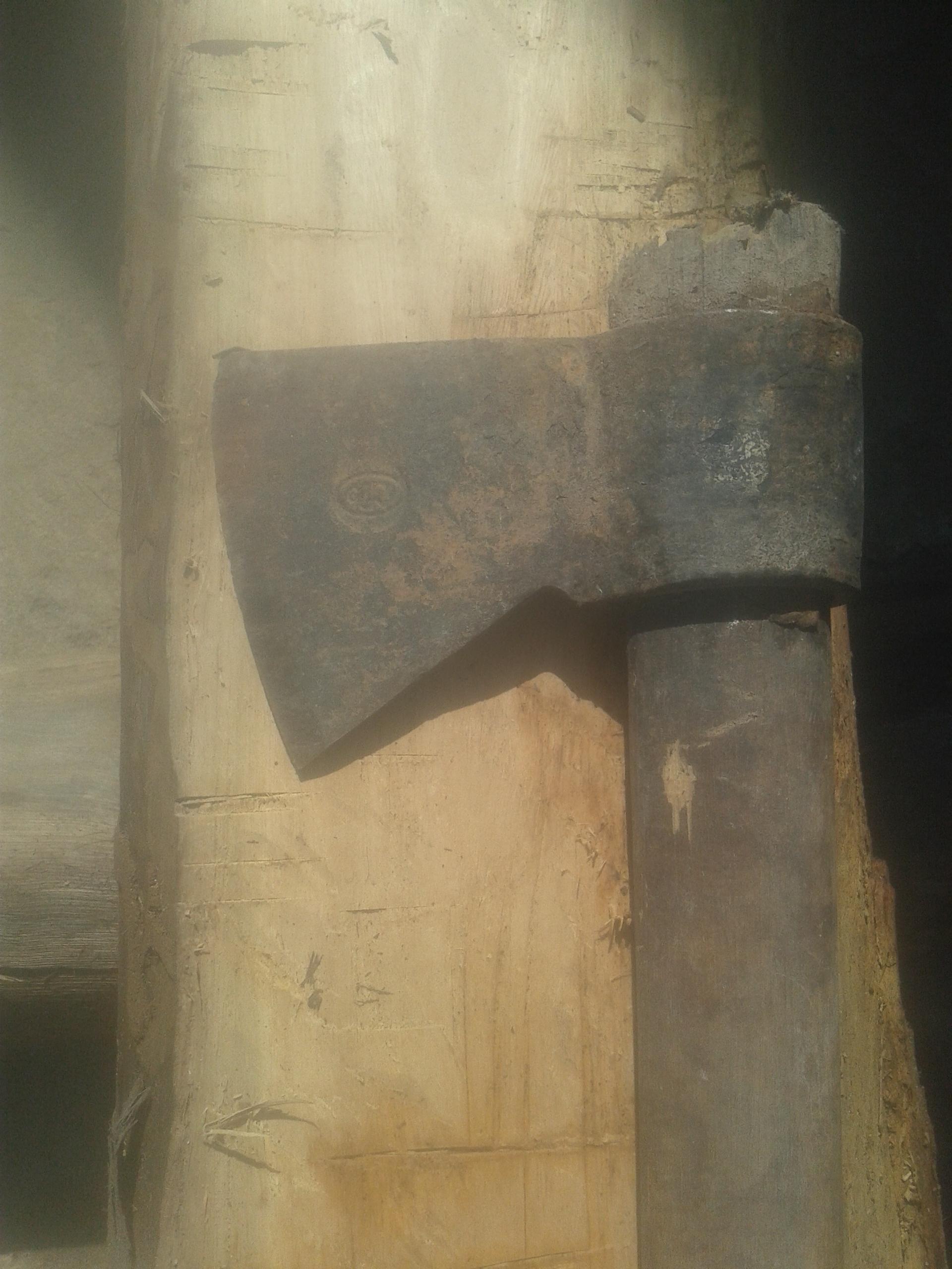

curiosity:
Stirring in my father's tools today, I found this ax.
"São Romão"
Sharpening only one side, about 15 degrees. It seems a gentle convex.
The sharpness seems to be original. And the ax does not seem to be for special uses.

Ziggy99 very good work!
Operator1975 Think the same...
In my case, the polishing of the wire is secondary.
As I used to cut more logs on the ground or splitter ... inevitably the blade ends up hitting the ground one time or another.
For more careful than I have, from 1000 hits 1 I error. then I take this factor into consideration. 20 degrees on each side, fine stone.
If I should count only hits would 10degrees on each side.
As you can see in my pictures first, this 20 degrees represent a 2-3mm in the face of the blade. then there is still a great power cut, but the sturdy wire to minor accidents.
As to the polishing face, makes a big difference in any case.
I recommend a test.
Thanks Lucas :)
