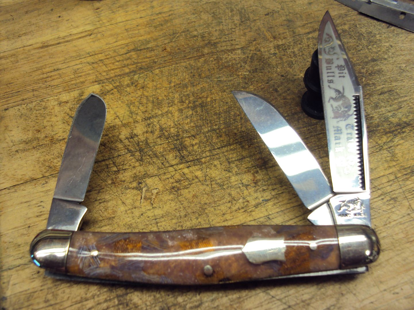

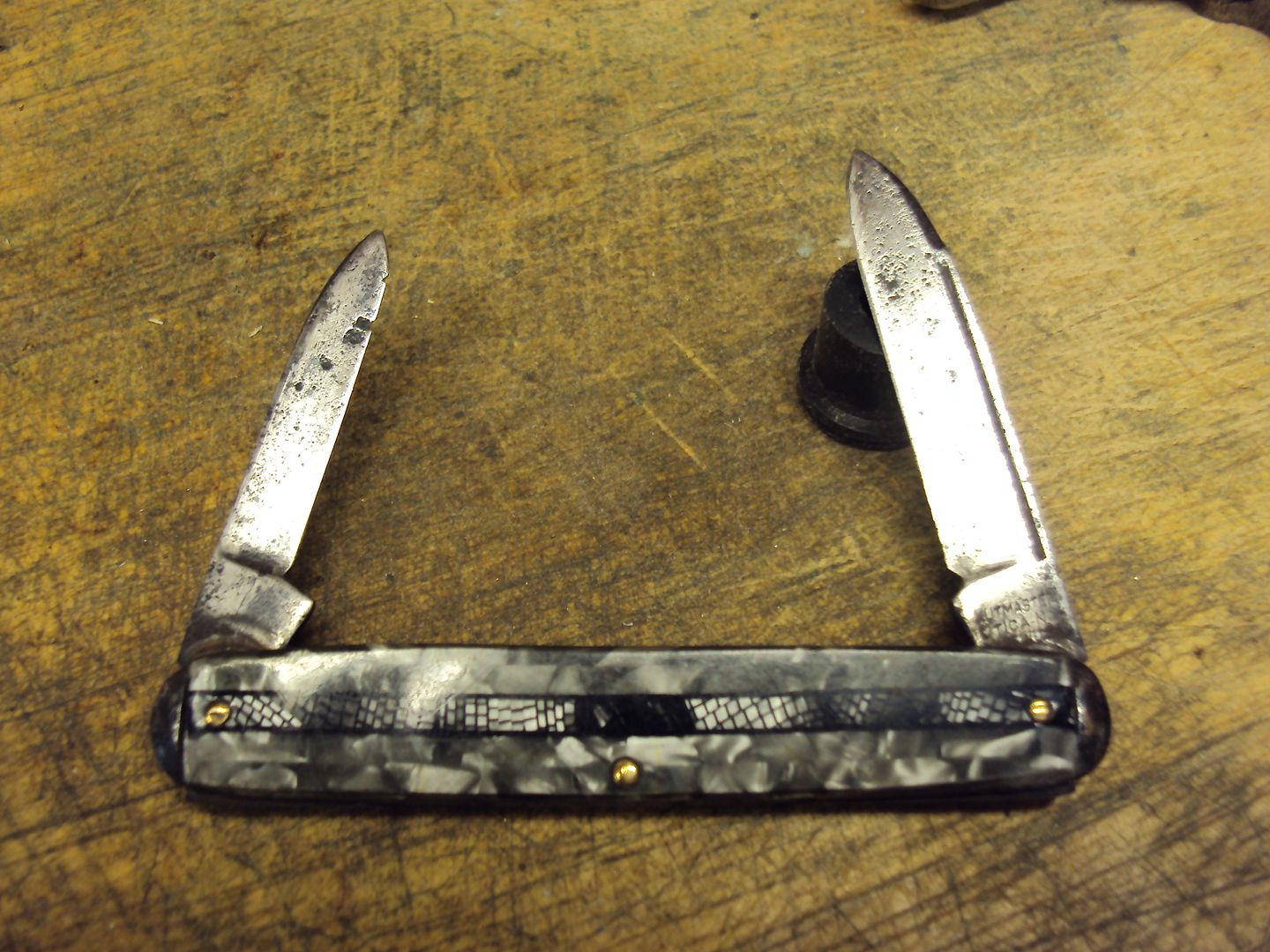

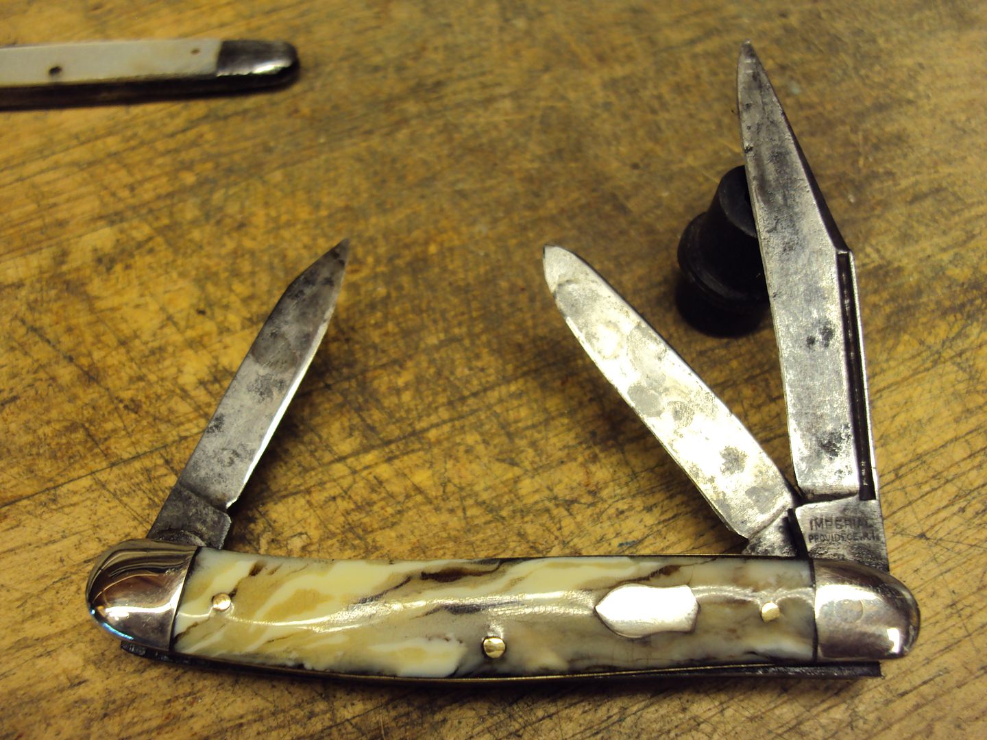

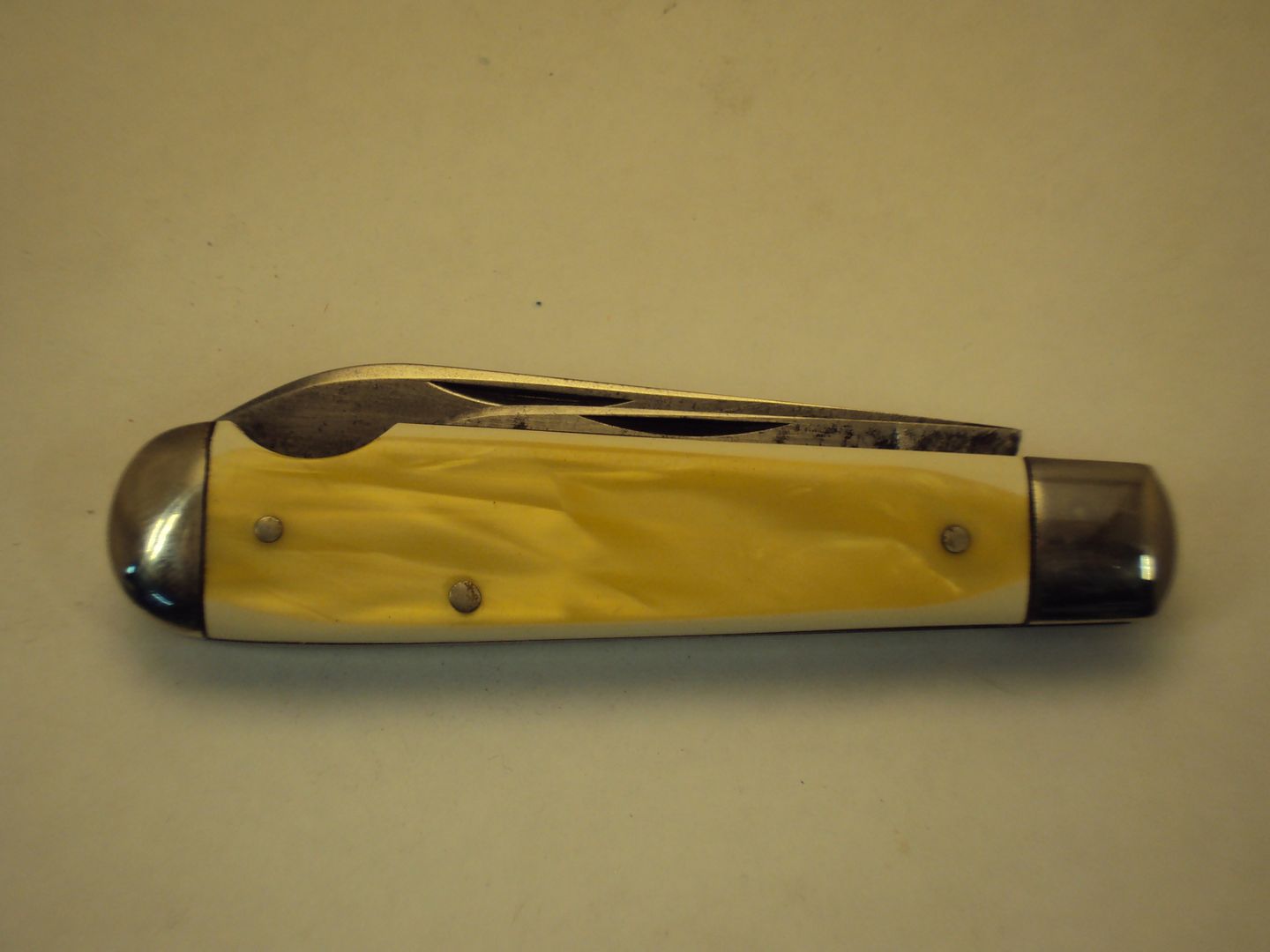

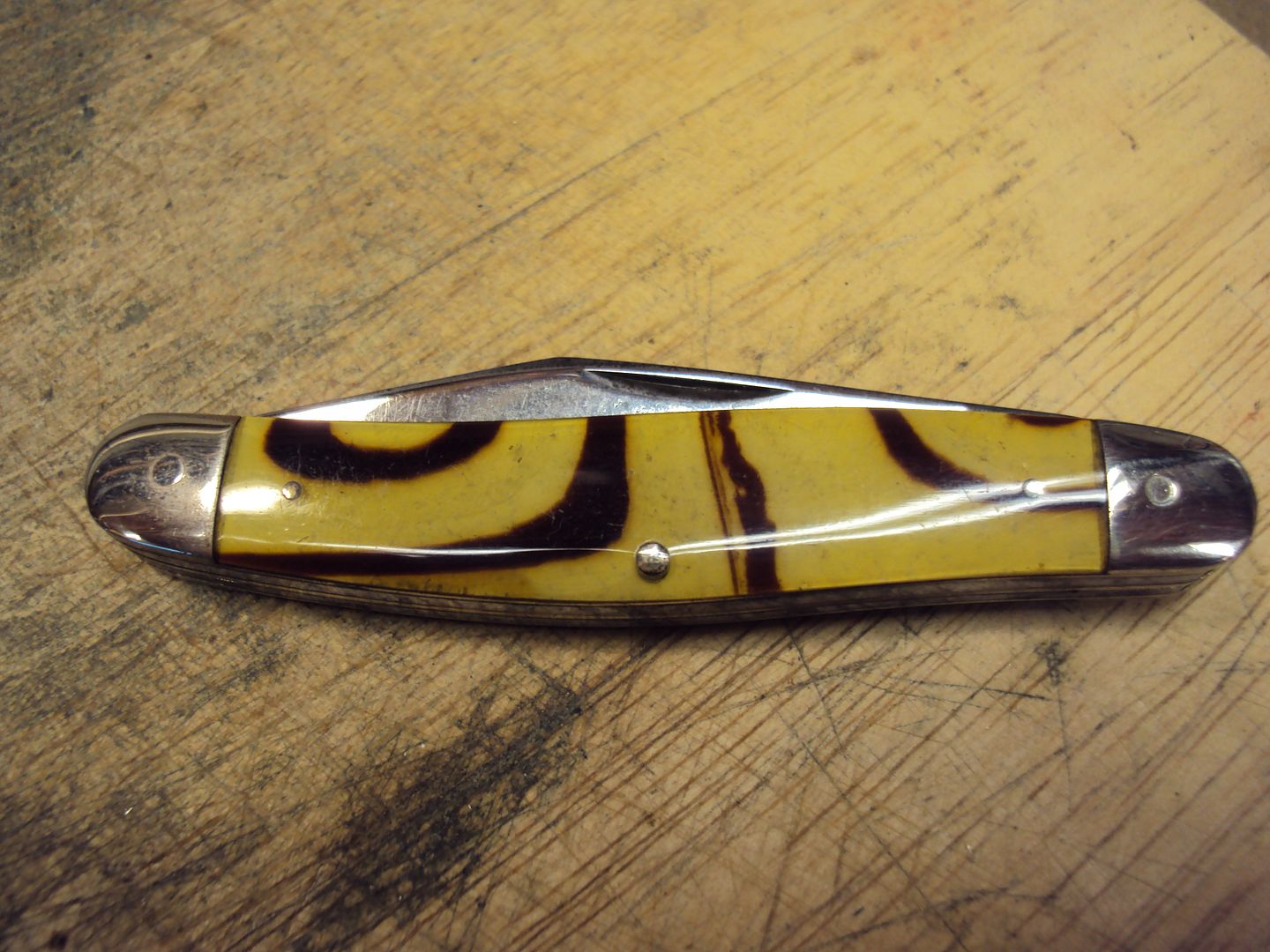

Examples of cell...
And some examples of outgassing...
I do have celluloid knives. I just keep a careful watch on them. They can go bad for no particular reason at any time. I have a knife that is a Schrade salesman sample, I've had it for years. No issues with it in all those years, clean as the day I got it. Then a month or so ago, I was inspecting it and discovered that it was starting to go. I had to take it apart to save it from going even further.
