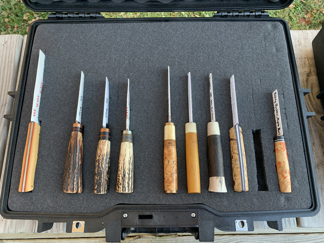

I like to see my knives. I've been keeping them in one of those upright blocks you get at the kitchen stores that are filled with plastic rods, and I hate it. Aside from the issue of having too many knives to cram into that thing, it sure does seem to dull the blades from the friction against the plastic rods.

So I was scrounging through a salvage shop last week and came across what I suspect is an old postal letter sorting tray. Here's what I've done:
Mine are mostly laying around... but I do coat them with "nipple cream".
It's 100% pure medical grade Lanolin & food safe.
we use felt w/ a sticky backer here in the shop w/o any problemsGiving this old thread a lil bump in order to get some opinions...
Has anyone experienced the green/brown/red dye from felt used in machinist’s tool chests transferring over to the handles of the knives when stored for a while? And if so, what was the solution?
I’ve been using the cheap, thin microfiber cloths sold with car washing supplies (because lord knows I’m not using them on my jeep) to line the inside of the chest drawers, just in case. I’d prefer to just lay the knives directly onto the felt, but I don’t want to take the chance of the felt color bleeding onto places it doesn’t belong.
Not sure if it makes a difference, but I started putting desiccant packs inside the chest to help with humidity, and I regularly use Howard’s on the scales and mineral oil on the blades.
ANY advice would be welcome. Thanks!
	Thanks, Phillip! I would imagine that those don’t sit around for too long in the shop.we use felt w/ a sticky backer here in the shop w/o any problems
Here's about the best discussion on storage of metals that I've found. In a nutshell, keep them clean and dry.

I coat all my blades with Renaissance Wax with zero problems with any of my knives, including all my 01 steel blades. I keep my blades in a tool roll http://www.ruffianspecialties.com/products.html?p=1&rs_product_type=108 from these folks. Considerably cheaper and every bit as good as the waxed canvas ones you see offered on some knife sellers web sites!Giving this old thread a lil bump in order to get some opinions...
