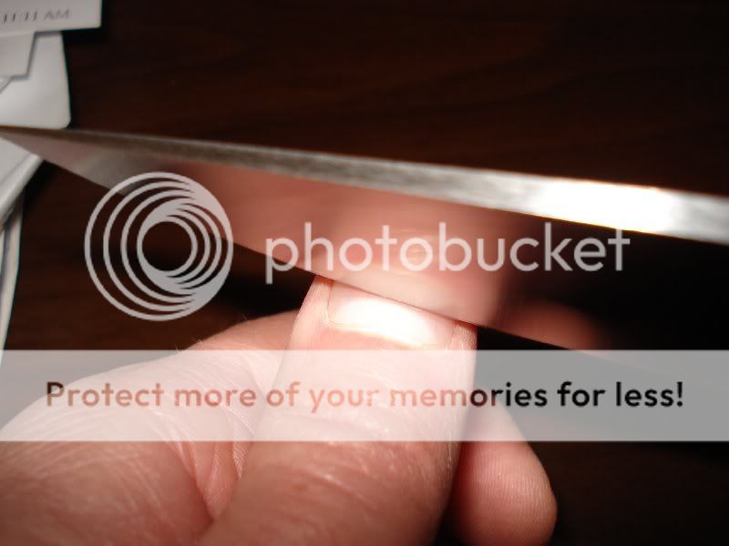

Like others I test sharpness by push cutting paper and shaving arm hair, but thanks to others here on BF I've learned two new methods that I really like.
The first is the fingernail test. Set the blade on a nail at a very slight angle and if it is sharp the blade will bite into the nail and not slide off.
The second method doesn't involve any cutting at all and may be the best method once you get use to it. Just hold the knife up to a bright light and let the light reflect off the edge. You may have to experiment to find the right light and position to see. But once you figure it out you can see if the edge is evenly sharpened or if there are any places that are rolled or chipped very clearly.

Yes, this is becoming a more useful check for me also. I usually do it after I've done my shaving/paper slicing checks. I've come to recognize that if the blade isn't quite plunging into the paper as effortlessly as I'd prefer, it's usually because the edge (or a small section of it) is rolled to one side or the other. That's when I'll hold it to the light as described above, and look for the shiny areas on the edge. It's nice when it's perfectly straightened out, and the edge effectively 'disappears' as it's rotated into the light.
This is almost universally helpful in inspecting folding knives' edges that might've come into contact with the inside of the backspacer. Some folders don't allow adequate clearance between the blade edge (usually somewhere near the tip) and the backspacer, and the edge smacks into it when the blade closes. Always leaves a 'flat spot' at the point of contact, and a telltale nick in the backspacer. More than a few times, I've noticed the flat spot on the edge when holding it up to the light this way, and now it's one of the first things I look for when inspecting a new knife.

+1 This is my method also, except I use the bright light first, then once the entire edge looks good, the fingernail test. I then shave some hair off my arm, habbit I guess.
