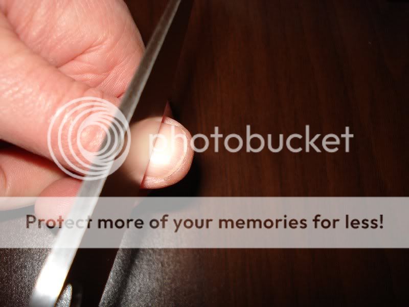

The first is the fingernail test. Set the blade on a nail at a very slight angle and if it is sharp the blade will bite into the nail and not slide off.
This, then I also run the edge of my thumbnail lightly down the length of the edge. If it catches anywhere I smooth it out.
