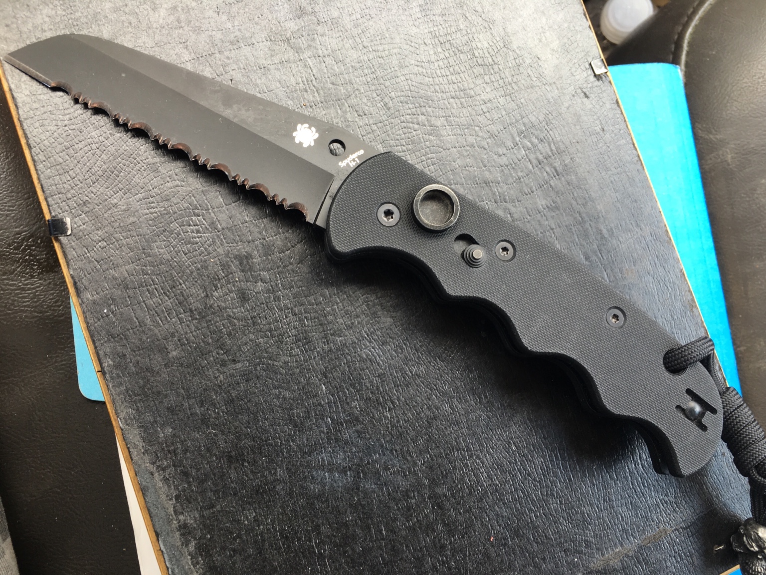

This thing will cut just about anything we come across Murph!! It is also tough as nails!!!
And for $80???? Excellent value???
Joe
If I can get this thing this sharp......anyone can......on a Sharpmaker!!
Loved the Pac Salt so much I grabbed one of these also!!
Another pocket chain saw!!

So what is the bottom knife shown? Very nice. Would like one of those :)
