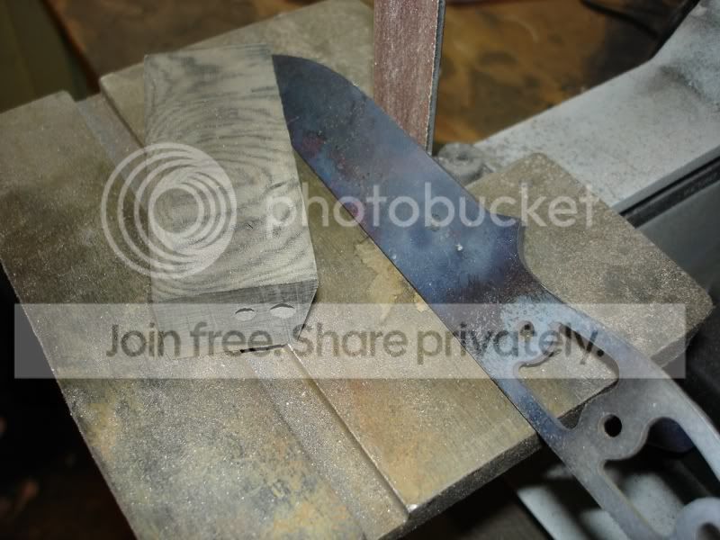

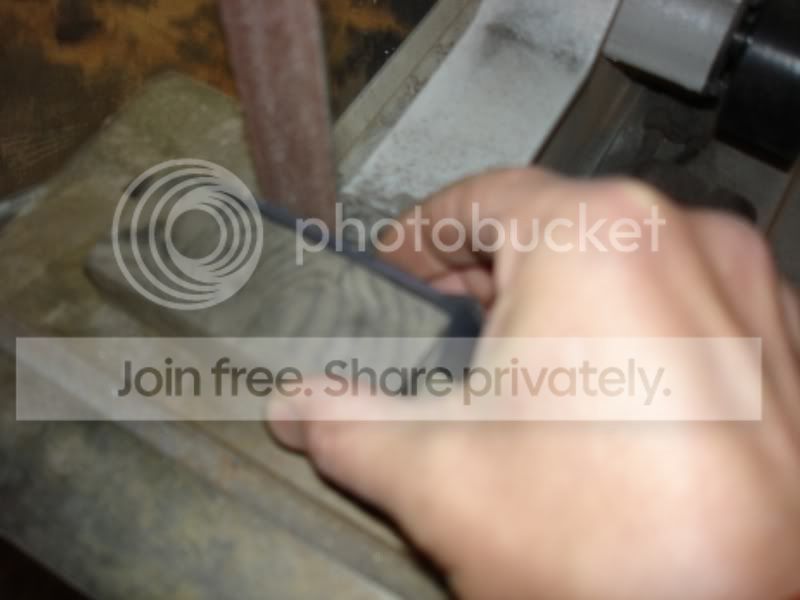

My solution was a little more low tech. I had a block of micarta that I mis-drilled. Using the disk sander with an adjustable work rest, I ground one side to a 12* angle and use that for a guide. It's kind of a combination jig/push stick. You can change the angle to suit your needs. I've made a few others out of some hardwood blocks, but I have to be careful when I dip my blades to cool them off. The wood can get too wet and swell.
It will still take some practice to get the hang of getting straight grind lines and making the curve on the tips using this.

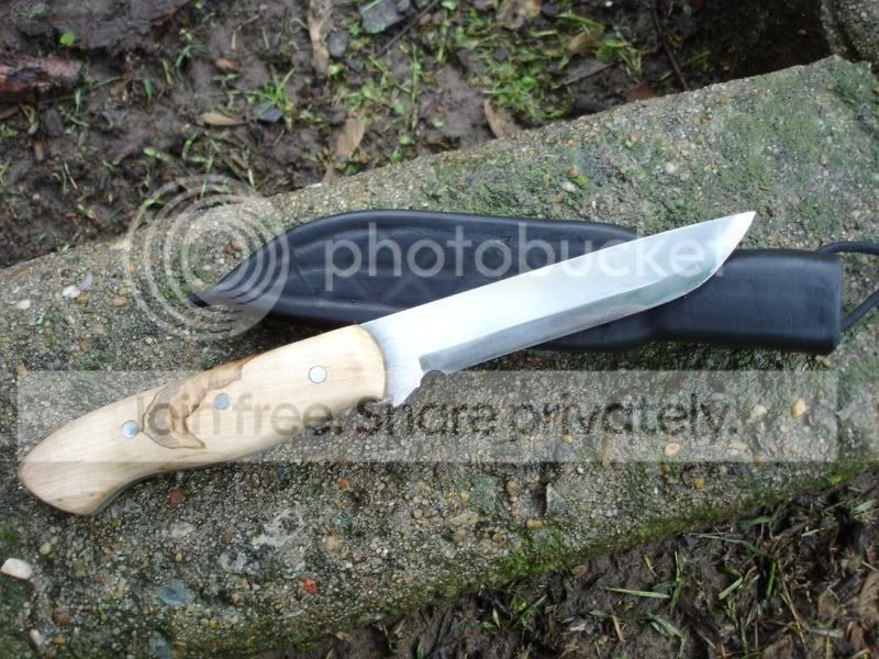

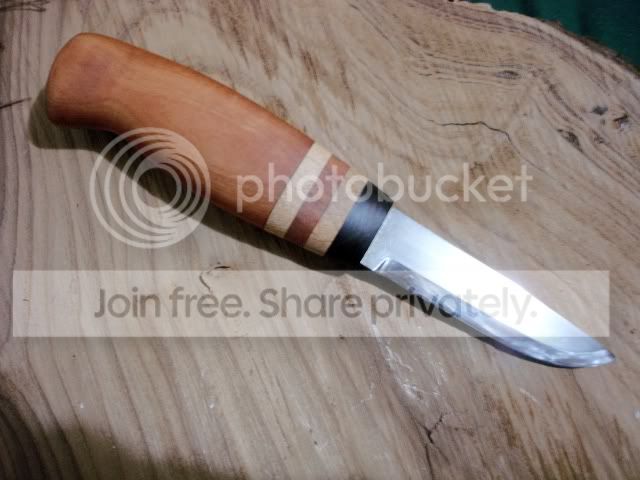

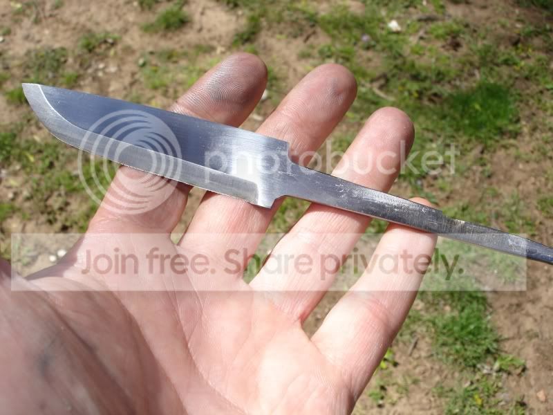

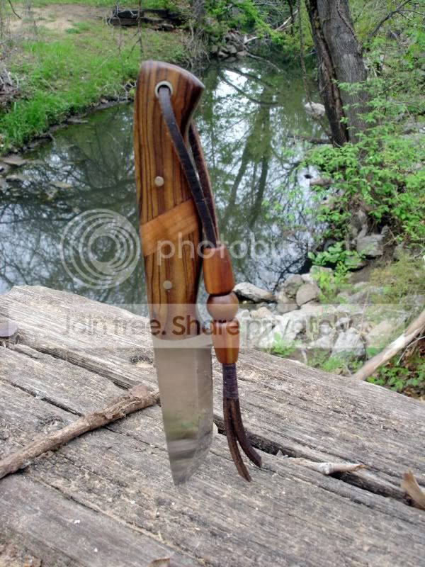

Here's a few blades I've ground out using this method.
