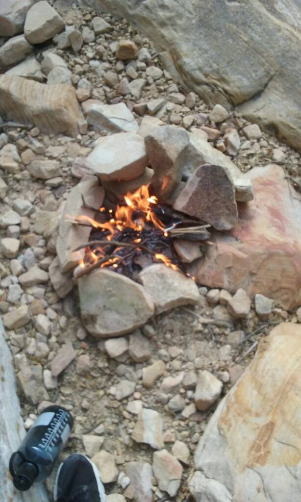

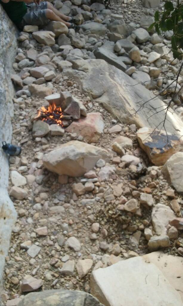

My little "scout" fire up in the mountains the other day. It was built with flint and steel with bark from sage brush, small twigs, and some pine resin. If we're talking just until there is an actual sustainable flame I was well under five minutes the pictures here are probably ten minutes in.

Nice work Stainless.
Yes prep is key. The most time for me was making shavings and finding dry twigs that were small enough.
