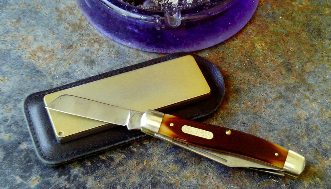

The Lansky even fixed this one:
The knife was given to me by an older fella that told me it wasn't a good knife, wouldn't hold and edge, and couldn't be sharpened. It had sat so long in a dirty drawer with no use it was nearly rusted shut. When we were talking about it, he told me that likewise, it was given to him for all the reasons he explained to me. This knife is about a '69 model, and with 2 owners had spent almost all of its time in a drawer because the owners couldn't sharpen it!
The grind is steeply obtuse as the main blade is about 1/2" at the kick, and an 1/8" thick! That means with its sabre grind it went from 1/8" to the cutting edge in about 1/4". Really steep...
Reprofiled and ground, it is now a favorite work knife for the Fall/Winter seasons with its carbon blades.

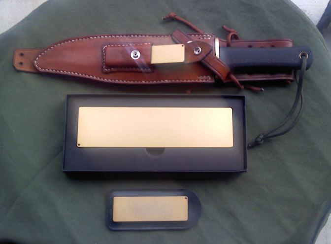

Fallkniven DC4 Combo
DC3, DC521 and DC4 (size comparison)
