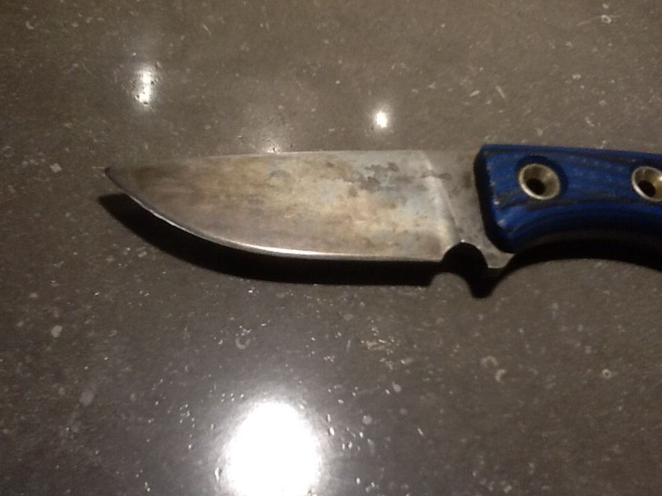

I've got a satin finish, blue G10 scales, Rodent 3. I bought the little beast about 2 years ago. it's been a kitchen knife (and EDC on several days.... One of the best fixed blade EDC in my humble opinion ).
It's tough keeping the satin finish on a SR101 knife. I decided to plunge it in a glass of vinegar. The blade turned a dull grey color. It now has changing stains on it.... Sometimes blue, sometimes black. I recently re sharpened it using a Spyderco sharpmaker. Darn little thing cuts like a bloody laser.
So, basically, SR101 makes for a darn SHARP (stays that way a long time), easy to sharpen, tough as all heck of a knife.... What's not to like?
Oh, yeah! Soooo comfy to carry.... I've got it in a David Brown sheath with a Gclip.
Never took it in the field though. Guess you've got to wipe them down, after every use, to keep them rust free.
The stains look like dark clouds whipping by on a windy day ;)
....and no, I haven't been drinking or using wacky tabacky

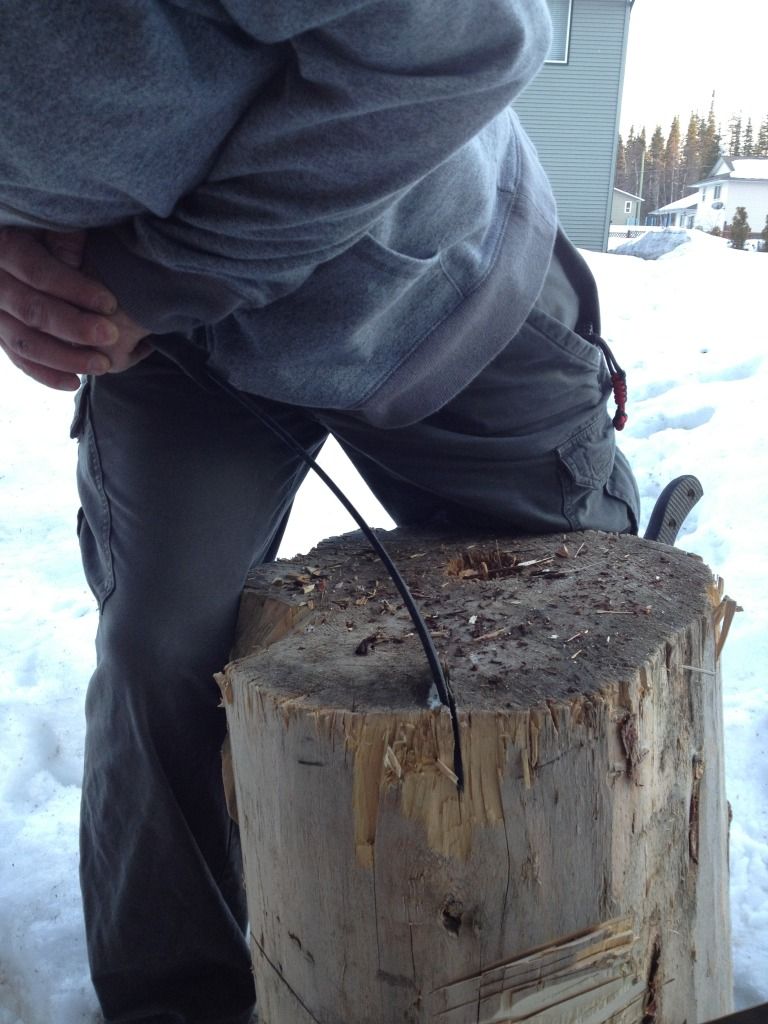

This is 3/16" SR101 at about -10c
Seems pretty tough to me. I've beaten the hell out of SR101, and it stands up really well to 98% of any level of extreme abuse that INFI will take. The corrosion factor is overblown too IMHO. Staining will happen, and light surface rust if you're really negligent, but it won't be a useless pile of rust if it's left outside in the rain overnight. It won't be as pretty as it was, but a little wash and scrub , followed with a bit of oil and it will still do knife things like before. The use will probably clean it up more.
