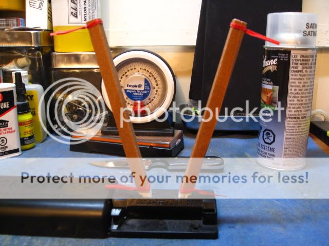

I have done a small modification to my lansky turn box kit where I use a rubber band to strap a diamond paddle to the 20* side to get the edge back quicker then the normal medium ceramics.
I do this to maintain my micro bevel of a 17* main bevel. The diamond is fine and I found it to be ideal to maintain and correct minor dings and nicks in the edge.

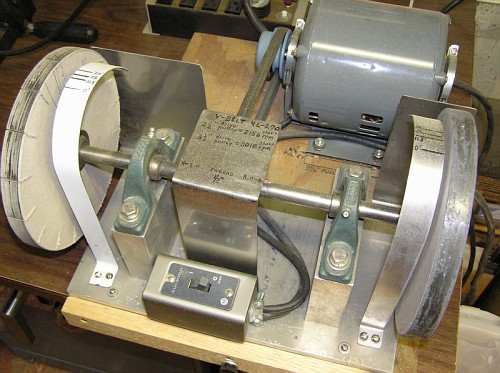

IDK if it counts as a modification per se, but I built an adjustable block that I set my stones on. It holds them at whatever angle I like and I simply hold the knife flat and stroke the stone. Sort of like what your image shows except turned on its side and adjustable to many angles.
I made a video and posted here a while back...here is a link to the video if you like.
http://www.youtube.com/watch?v=AXhrqfV5jvs
(sorry, I do not have any still photos of this thing)

I measure and cut sand paper so that it's exactly long enough to wrap around the three sides of the stone. Then I leave just a little bit of over hang, so it can be tightly wrapped and folded around the sharpmaker stone's for heavy re-profiling.
Fold the sand paper nice and tight around the stone's, and hold the paper in place with either twist or zip ties.
I start with 150 grit and sometimes work my way up to 2,000 girt in the 30 degree slots. Then when the bevel is completely 30 degrees and has a decent enough polish to it, I move on to the 40 degree slots and micro bevel the very edge. I Always finishing everything off with the ultra fine rods, which produce hair whittling sharpness.

The material is SS and the green material is UHMW. (ultra high molecular weight) It has very high ware resistance. It was cut on my table saw with a carbide blade.
The piece holding the stone was made first just to hold the various size stones. Then I thought I should make it also vertical and go in a stand at different angles for sharpening. Made the base about three weeks later. The holes in the base are drilled (1/2"dia.) to accept the stainless rods. Each pair of holes are drilled at a different angle. Not to hard with a drill press. You can use it with downward strokes or take it out and lay it flat on the table to sharpen freehand.
The combo waterstone in the picture is 8" in length.
The 1st Lexan one in the other picture has been modified to make it easier to adjust. No screws. Just slide out the middle support and put it in another slot for a different angle. Lexan also cut on table saw.
