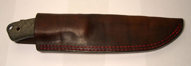

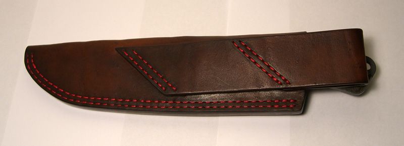

Second attempt at a sheath. My first sheath came out fine for a working sheath, but I wanted to apply what I learned from my mistakes and try a crossdraw belt loop. Of course I made mistakes, but they are perhaps less glaring this time.
I think I did not let the sheath dry completely (I let it sit for two days) after wet forming before I started working on finishing the welt edge. The gum trag kept sprouting a crust which would return after I rewetted and reburnished it. I hoped that the beeswax/neatsfoot oil finish would clear it up but it looks like it encapsulated it for good.
Thank you Talfuchre for your guide and advice! I have no idea why this tutorial isn't a sticky it is one of the clearest and most helpful ones I have seen...
It is 3 strand 0.8-0.9mm nylon I got from a chinese seller on ebay. It took me some searching to determine what red nylon thread to get as there are so many different size designations for thread. I can't comment on the quality as I don't really have anything to compare it to and it's the only thread I've used. It seems okay...I have broken it and it can unravel when getting waxed, but maybe that is typical.
Not typical - but stitching in a sheath - with proper gluing - is damned near there for looks. If your stitch groove is the right depth - it won't get wear.
I have to tell you - I have looked at your sheath multiple times - and I don't see any glaring mistakes. We are always our own worst critic. Remember, if the stitching is PERFECT - it looks machine sewn - and I think looses its charm.
The only things I would have done differently are - not leave the belt loop pointed - it may start to pull there.
Also - be wary of straight stitches at wear points - they can 'zipper' on you and tear. You are essentially making a straight line of holes for the belt to tear the belt loop on. However - Now that you know how to make an awesome sheath - you can just make another if it tears out.
It looks like you used shoulder leather and have the natural creases running perpendicular to the blade. If you like the look - great - just be aware of these lines in the future - and use them to your advantage - place them how you want them.
I, personally, like those lines in rustic sheaths. A little 400 grit sand paper after the dye dries and you can 'age' your sheath - then seal it. It takes those shoulder creases and enhances them a bit - giving your sheath a 20 year old look.
These are just LITTLE things though - and I hope you don't take them negatively.
I think the danged thing looks awesome - and wish my second - or hell 20th sheath looked as good.
