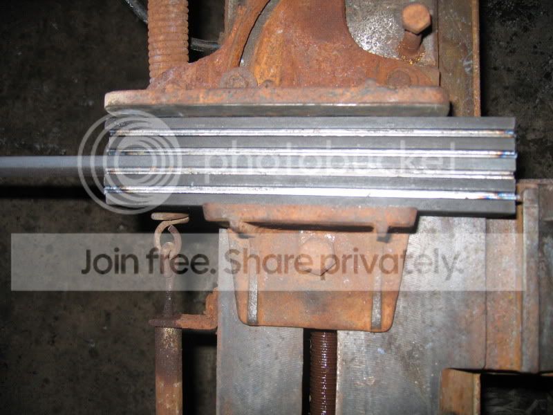

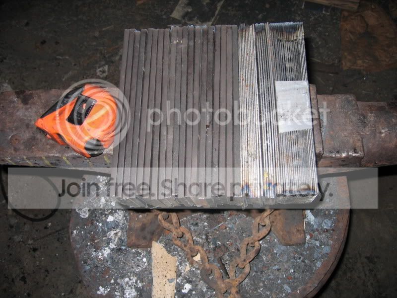

First I start with a whole bunch of 1084v and 15n20 cut into 8 inch sections.

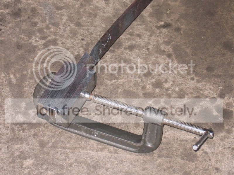

I then arrange the steel in an alternating order with two pieces of 15n20 in every other layer and 1 layer of 1084 in the other, with a total of 9 layers. The center layer is a full length bar of 1084 so I have a handle to hold onto. The steel is then lined up closely and clamped in place.

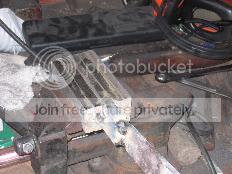

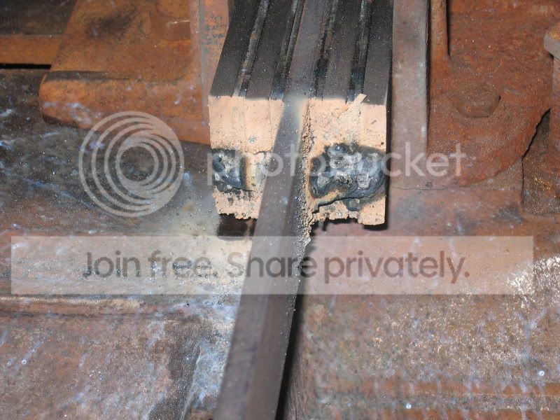

I then put a strong bead down each side to hold the billet together until it is forge welded.
Welding section to come soon.

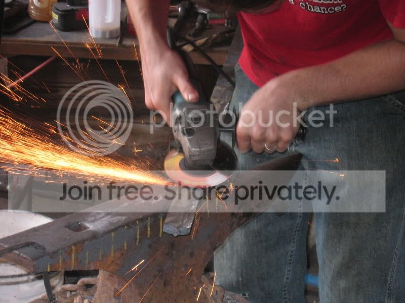

After the welds are completed I grind off any lines on the side of the billet that are a sign of an un-welded piece of steel, caused by minor misalignment in the pieces of steel.

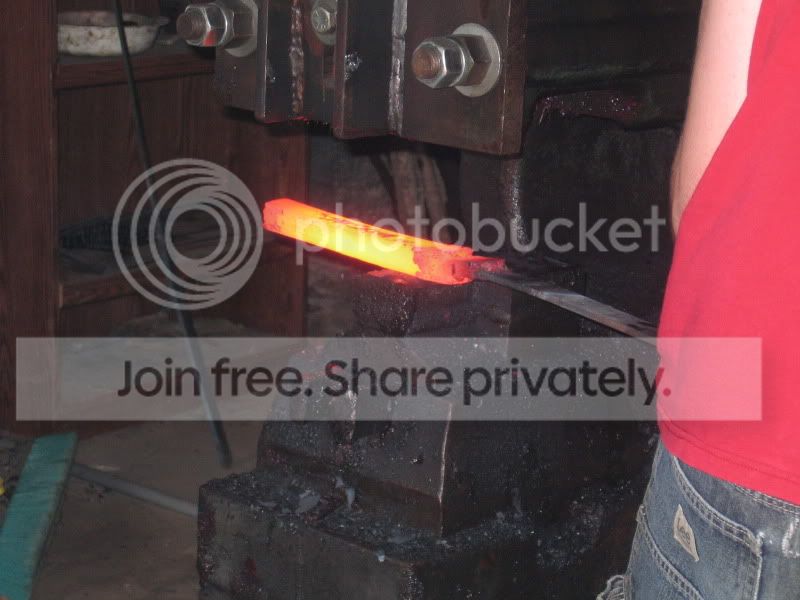

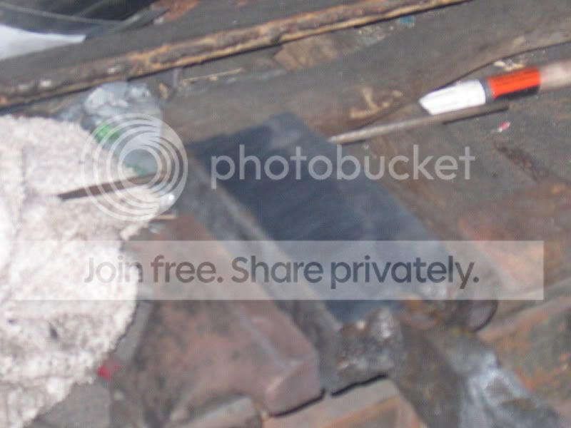

After grinding and through inspection of the billet I draw the billet out to 3/8"-1/2" thick on the power hammer.
Once the billet is cool I grind both sides with the angle grinder to remove all forging pits and examine the bar for defects. This removes the pits that could trap flux and create minor cold shuts that would not be visible to the smith.

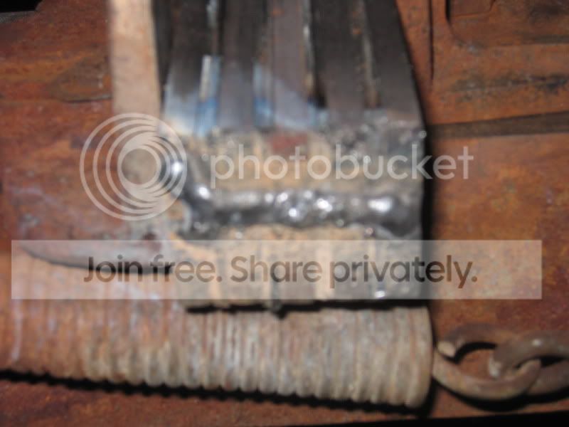

I then divide the bar into five equal parts but only cut off four so the fifth bar remains attached to the handle. The bars are then stacked and welded with a vertical bead on each end.

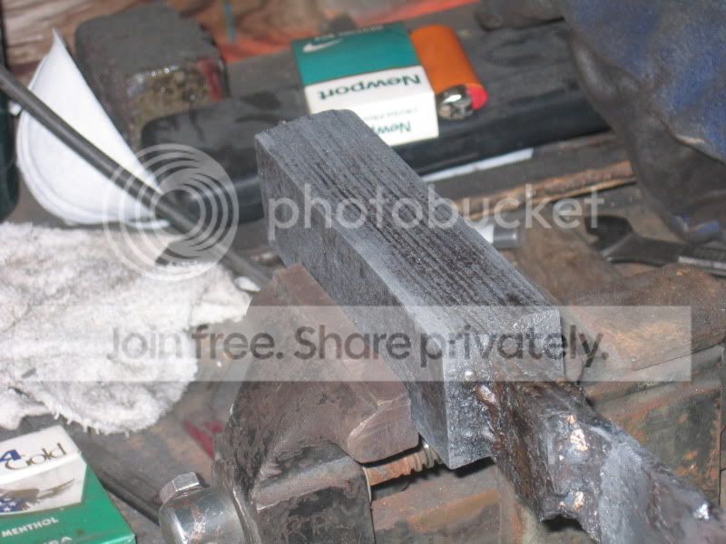

The billet is then ground even on each side.
After forge welding the bar is again ground on each side to remove the over lapping steel that is not welded and to be thoroughly examined before it is drawn out.

THIS IS GREAT!! What type disc do you use on your angle grinder? Is it absolutely necessary to grind off all uneven sides of billet? If you draw out ..say to 20" and then cut into 5 pcs and restack..why do the edges need to be ground clean? Thanks.
I use a type 27 hard disk for rough grinding and hot grinding. I use a flap disk for smoothing the surface after the rough grinding.
Its not absolutely necessary to grind the edges clean, its important to grind them even though. Any overlapping steel can cause a cold shut when you forge it. Also its important to grind out any gaps on the edges after welding, as these can also become cold shuts.

How big a Fairbanks Hammer is that and did you build the replacement front plate or did you get it that way?

Mike its a Fairbanks E 150lb model. The rebuilt front plate was made at a local machine shop for the previous owner.
