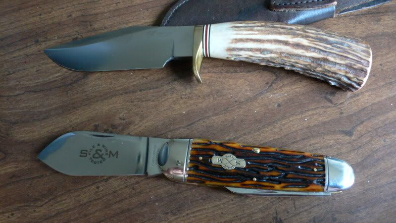

Certainly. The first thing I learned is that I definetely need a tripod as is evident in this photo!
Obviously, the window is to the right of the photograph and the light far too intense on the scales area. I knew it when I first saw the photo on the screen but was unsure how to correct it. After reading this thread I've learned that the way to correct these kinds of problems is via trial and error. What I think I would do when I next photograph some knives is turn the knife 90 degrees so that the reflected light would not be more intense on any one portion of it. After reading here it sounds like common sense but.... something about common sense being not too common! :)
And the same applies here. Too dark on the blade, too much light on the handles. (Entirely OT, I apologize, but what should I use to clean the stag on that Trailguide? it looks worse in the photo then it actually is but it definetely needs some tlc.) Also, I suspect that this photograph would see definite improvement if I had used a reflector.
also, your postings have convinced me that I need to pay more attention to the angles regarding both light and reflection. Further, I've become convinced that I really need to give background more consideration. I think the neutral backgrounds as shown in this thread just naturally lend themselves to better representing the true subject.

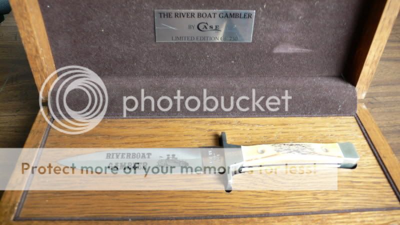

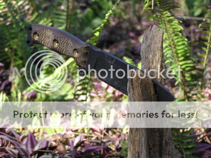

I'll include this one because I think its one of the better knife photographs I have and its in my photobucket account. Its a bit too dark though, I think.
Roughedge I do appreciate you showing your work here. I don't think they're bad at all. It's hard to get good lighting on a knife when it's in a box, you did good. Of course it could be improved in Photoshop by balancing out the light, by dodging and burning.
Your last photo is a little busy for me. Maybe if the background was thrown out of focus. Once again I'm not big on props or backgrounds.

Agreed on the last photo. I've considered trying to blur the background in photoshop but its beyond my current knowledge. It may be best left to the other thread but do you have any pointers?
One of these months I'm going to sit down and dedicate some time to the giant 7 dvd PS tutorial I have!
I was planning on doing a tutorial on How I Do Illustrations, but right now that's on hold. To answer your question briefly, you need to make a Selection of the knife and the stump. There's lots of ways of doing selections in Photoshop. For that particular image because it's rather complex I would try the Extract tool under the Filters menu. Or the Magnetic Lasso tool.
The procedure would be to duplicate the Background layer, make your selection, put it on a separate layer and then apply a Gaussian Blue to the background. he hardest part of course is getting a clean selection.
Roughedge, since you were nice enough to post here, I thought I would take a few minutes and play with your photo in PS.
It's still busy, but I think the focus is more on the knife now.

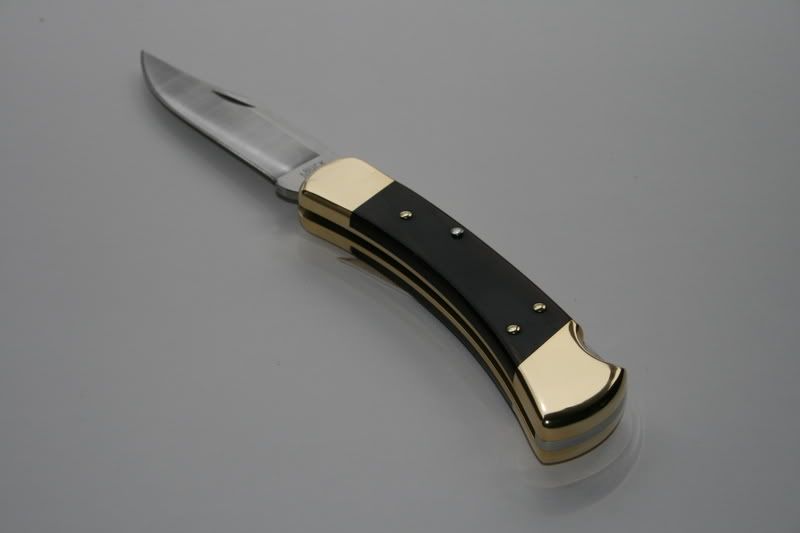

Top left, was the first pic Juggler showed. It’s off color, probably shot with tungsten lights. I can’t tell what the actual color of the fabric is, if it’s yellow it’s just adding to the off color look. The blade and bolsters have no light reflected into them.
Top right, he’s moved to the window and the color looks a lot better. The window is off to the left and he still isn’t geting any reflections on blade or bolsters.

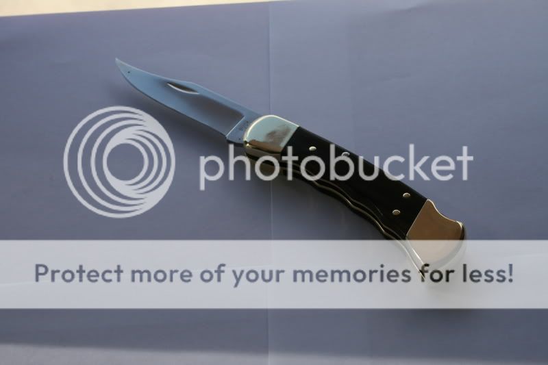

First let me apologize for the long delay. Everyday life can get in the way of "fun time" on occassion. First up, a pic of the setup used taking these pics. I used my old RCA Digital 1.5 megapixel camera to take the first pic. I cheated a little, forgive me. I used a piece of $.99 white poster board instead of typing paper, I used the "rough" side up, and the slick "shinier" side down. The only reason I made this change was due to convienience (sp?), if need be I will swap back. BTW, this pane of the bay window is as close as I can come to a north facing window. It faces nw.

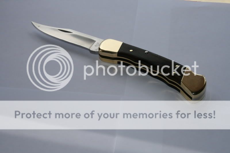

I actually think this is the better of the two, because the light is better. However a small piece of "non-slip" material is peeking out from underneath the knife. So I tried to take another series of pics.
This pic was taken roughly 5 minutes after the first pic. But today is a very dark day, heavy overcast. This pic turned out a little darker.
Juggler, we're looking pretty good with this last attempt. Seeing your setup really helps. It appears the problem you were having was that you just wasn't close enough to the window to get the reflections you needed. Maybe if you use the middle section of the bay window you can get even closer to it. The angle that you're shooting the knife at is a little low, I'd like to see you up and over it a little more. It also might look better if you point the the knife to the lower left corner. But, all in all I think you're very close to where you need to be and the improvement is huge.
Using poster board instead of typing paper is fine. My basic instructions are just that, Basic a place to start. Build on and improve upon it however you want. Don't worry about the stuff that's sticking out from under the knife that can be retouched away when you get to the Image Editing tutorial.
I think you should reshoot again. Without losing the reflections on the blade and bolsters, see if you can get a better shooting angle on the knife, ( more up and over it). Take at least four shots, with the point of the blade pointing toward the four corners of the view finders screen. Take another with the knife in the closed position. You may also want to try and take a closeup of the tang stamp. I think it's good to get into the routine of shooting different angles of your knives, open and closed and any details that are important on the knife. No better time to get into that habit than now.
