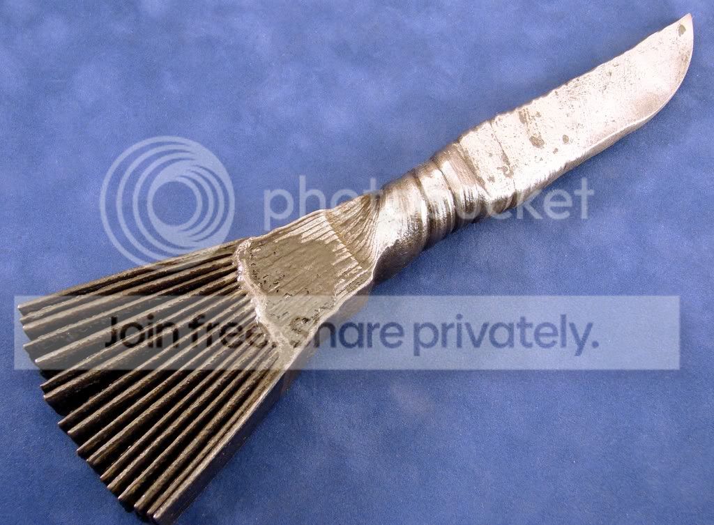

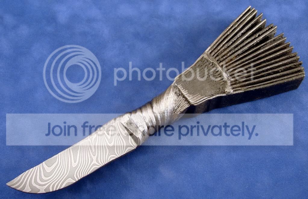

Like this.....
In a couple of hours I'll be loading everything onto a truck for Kentucky, and I'll be leaving next Tuesday morning. Since this is not a "Knife" show, the folks at the Montana Arts Council said that I need something to demonstrate how damascus is made. I couldn't think of an easier way to explain it than this piece. I also made a straight laminate piece that I didn't twist...just ground across it to expose the layers. We'll see if it gets the point across.:)
Was a bit confusing at first but as you explain it is a perfect sample for the arts council.
I have sample patterns in my shop but not to that extent. Have a good trip.
thats cool
and the only other thing i could see helping them understand would be clean the steel stock a bit on the "fantail" and etch it so they could see the different layers as they go in
I showed the photos to my wife, and she said, "That's definite proof that the pattern isn't just engraved on the steel, but proof that it came from the steels themselves".
I think you may have a new handle design there.
Travel safe, Fred
