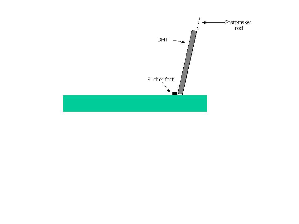

Because I do a lot of steel comparisons, it is important to me to get a precise, reproducible angle. I have tried several methods. The one I use today is a DMT extra coarse stone, which I lay against a Sharpmaker rod in the 30° slot. That gives me 15° per side. To get something as obtuse as a Queen rebeveled to 15° and sharpen it the way I want it for an edge retention test takes me a couple of hours, I think. I don't usually do it all at one go, so part of that is an estimate, but it certainly does not take 10 hours.
Hmm I like your technique of using an extra course diamand stone against your sharmaker rod. What size stone do you use for that?
A 2X6. They aren't all that pricey and they are easy to hold in place.
I took the plastic foot that comes with the DMT and stuck it to the base of the Sharpmaker so that the stone has a stopper. That way it is easier to keep the stone from sliding away from the rod.
