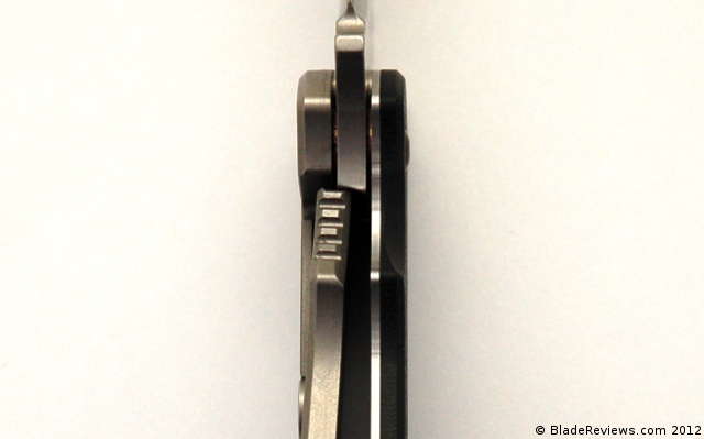

I guess I don't understand the concept of 30% or 45% LOCKUP.
Please help me out.
Gosh, that's sad to hear. I had my mind set on a 755 MPR. I like the design and M390, along with the shorter blade. I guess I'll write this one off. I want my knives to have solid lockup with no blade-play, like on my Para2 and Manix2 and BM 690.
Please help me out.
No don't get me wrong, my 755's lockup now is as solid as a tank(absolutely no blade play whatsoever)! In fact, it's one helluva knife and my favorite folder at the moment! If the lock wearing pattern is as what hardheart had described, then it puts my mind at ease knowing that the inclination of the lock when engaged won't increase linearly with time.
Here's a picture of how a 30%(approx) lockup looks like. The percentage of the lockup gets higher as the lock bar sits deeper under the blade tang.
You should have nothing to worry about, what your noticing is the lock face wearing in to its hopefully final resting spot. You should be able to get years of use out of it. Most production knives don't have the Ti heat treated unless your talking about a Sebenza or something of that nature. My Sebbie started out at about 70% and hasn't moved more than .0005 since I've had it but I attribute that to the HT on the lockface. Most of my framelocks wear in so there no worries :thumbup:even on a sebbie theres no worries if it goes to 90% as long as there is no blade play, basically what I think I'm saying is that it doesn't matter what your lockup & is as long as there is no play in any direction. and personally I like a later lockup b/c its safer
