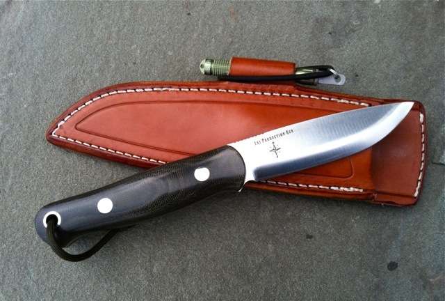

In my admittedly biased opinion, and given the various needs above, something along the lines of the BR Bushcrafter really hits the nail on the head:
- 3.8" blade
- 8.6" overall
- a handle that is comfortable in lots of different grip styles
- Scandivex grind, full tang
- .145" thick
- CPM3V steel
But the real brilliance is in the blade design - the modified drop-point puts the point of the blade just barely above the centerline of the handle, making it quite good for drilling, etc. But it also has enough belly to it for game tasks (unlike some other "bushcraft" designs). And the grind allows for a stout spine with a narrow edge that, being convexed, still allows for great edge retention.
Others may totally disagree, and with good reasons. But this particular design is extremely versatile for my needs.

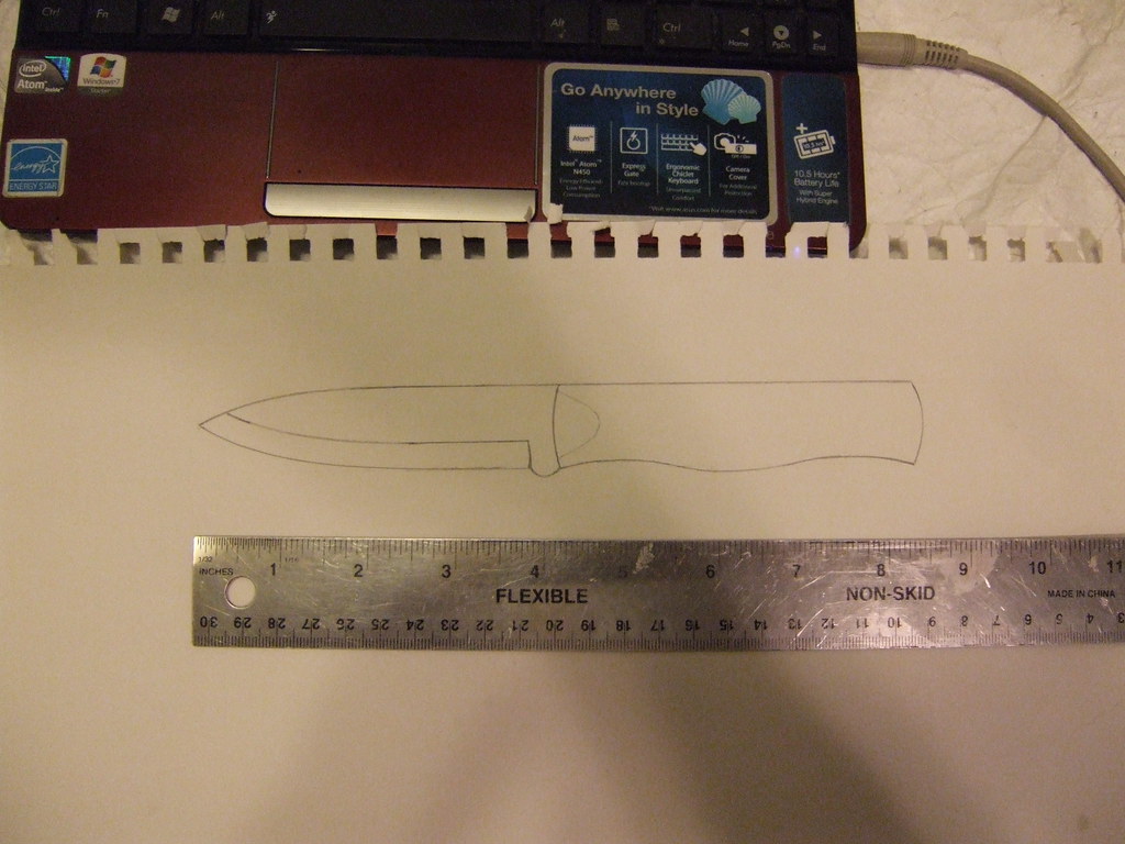

Doodling around with pencil and paper, I came up with this:
This one has a tip - to -scales measurement of 4 1/8", cutting edge of 3 7/8".
I saw a bushcraft demo on youtube where the guy says he likes to have a divot there at the front of the scales, to place his thumb.
I like. :thumbup:

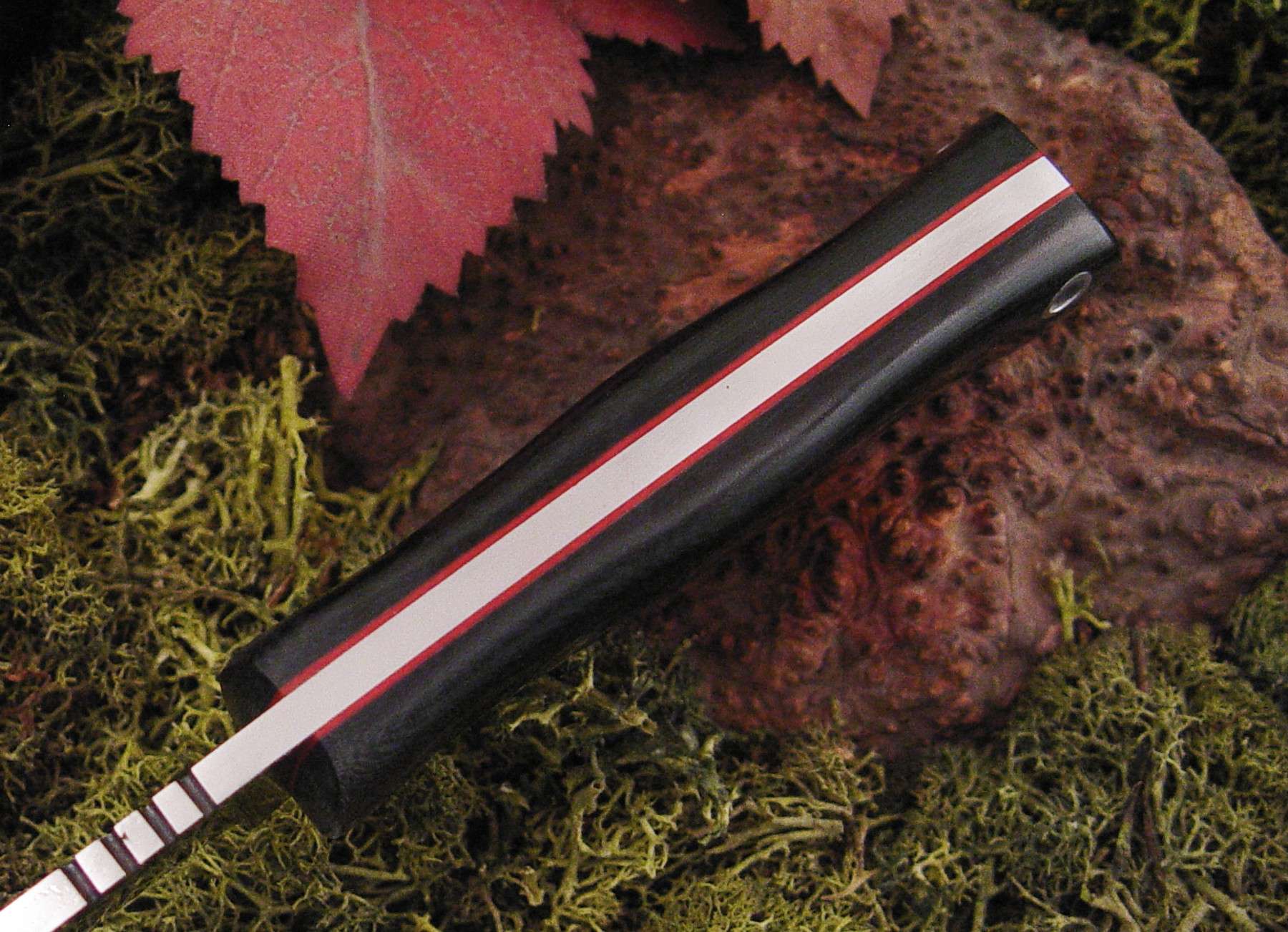

Kind of like this?
With the palm swell and the constriction near the front of the scales, I find the above to be a really comfortable handle, for a variety of grip styles. Obviously though, that will come down to a lot of personal preference, hand size, etc.
