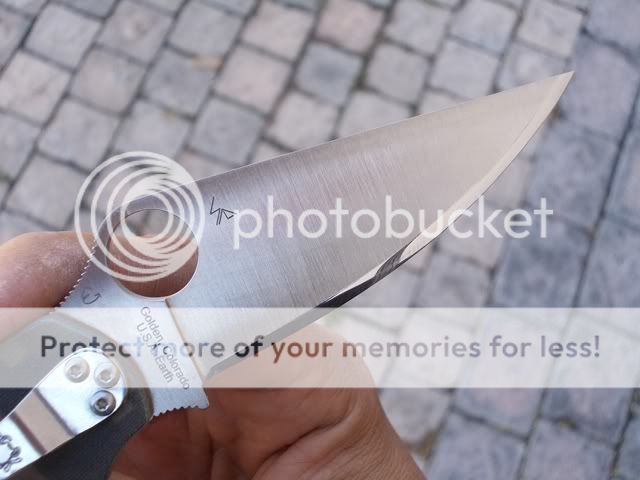

I've gone 12 per side with vg10 (ffg Delica) and m390 (Blue Para 2) The Para belongs to my friend Steel130 here on the forums so I didn't use it after sharpening but the vg10 held up quite nicely. I did add a 30 degree inclusive microbevel to the Delica after awhile just in case.

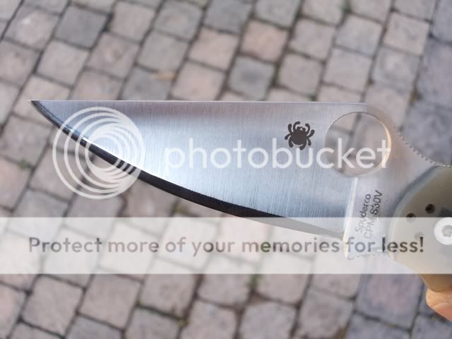

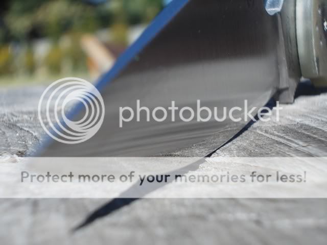

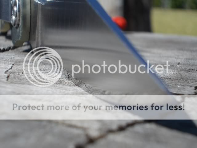

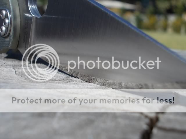

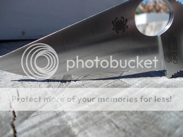

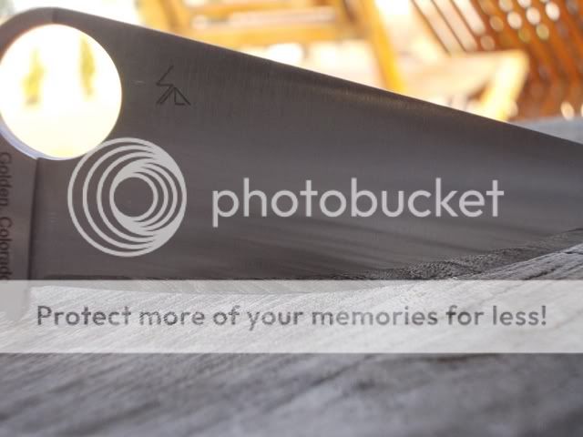

Lowest usable edge ive done is 9-10 DPS on my reground M390 para at 0.007 behind the edge reground by me.
same edge before the regrind
I EDC a reground Superblue Caly 3.5 at 13 per side with a 9ish per side back bevel
