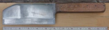

veggie cleaver I made, the edge is about 8 degree per side. aldo's 1084, 6" x 2 1/2", Rc 62-63, dogwood handle. cuts fruit, veg, and boneless protiens like soft butter.
