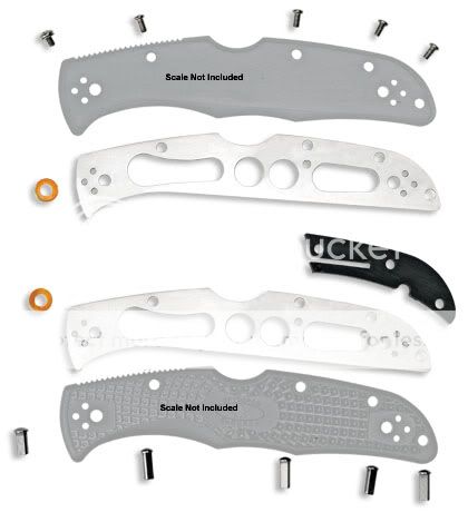

Why would Spyderco sell this if installing it voids their warranty?
http://www.spyderco.com/catalog/details.php?product=290
