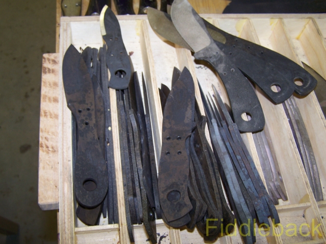

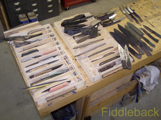

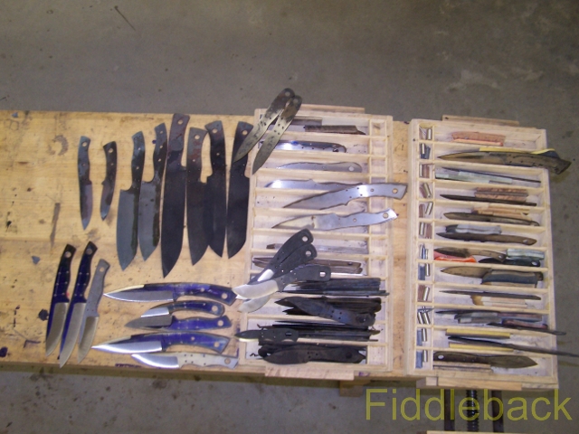

I am full time, and I think working in batches is key to profitability. I had my apprentice profile 82 knives in October. On the 20th I started drilling the blanks. Then on to grinding and heat treating. I've ground and heat treated a batch a day since last week, and have 14 left to grind. My goal (unattainable, but fun to have a goal) is to finish all 82 before Christmas. I usually finish 30 knives a month. I've got 17 knives going to get glued up today. I'll finish those by Wednesday of next week. By then I'll also be done with pre ht grinding, and heat treating of the entire 82 blades. After that, it will be choosing blades for batches, and finishing work. Repeat.
Lots of sanding days (all day sanding) before Christmas.
82 blades at once sounds ludicrous. So how about a pic?
