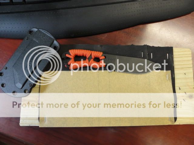

Here's my BK7 snuggled up to one of my strops.
I'll try to take some strop pics with Beckers. This is all I have in the Photobucket.
I'm constantly stropping as I use my blades. I try not to let them get so dull that a strop won't get it where I want it to be.

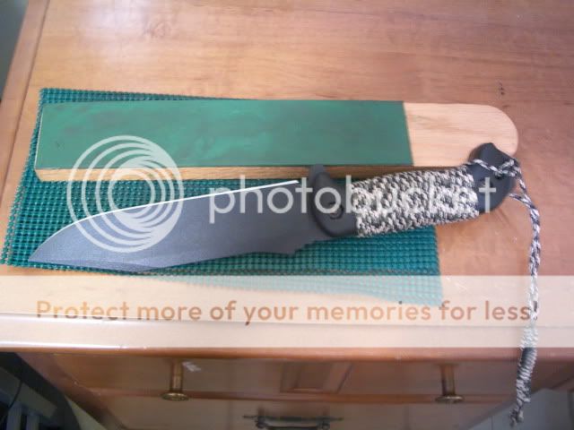

I've got a set from Mr2blue in bubinga. IMHO he makes the best strops out there. The large one has the Bark River Black compound on it, and the smaller one has the green. For speedier stropping I've also got a leather belt for my 1"x30" belt sander. That sucker puts a nice polished edge on the old BK-9.

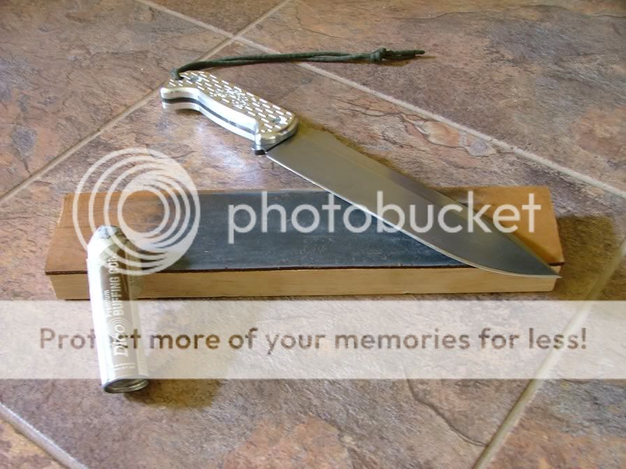

I cut a piece of a funky home-made guitar strap off and glued it to a piece of 1" x 3" board to make my strop. So, in essence, it's a "guitar strop." (Groan) Anyway, I use Dico white buffing compound and it works great.

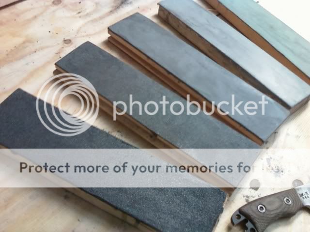

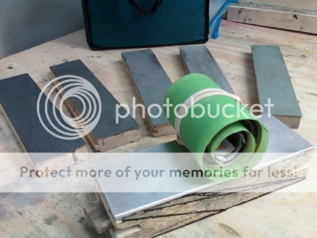

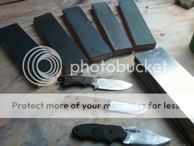

Here's a few of 'em and the block I do my wet/dry convexing and V grind. Marks on the block are quick reference for bevel angles. The real gnarly strop is 60- grit _doesn't get much use, the rest are 120, 220, 600, 1200 silicone carbide powder. I apologize for the off brands - a buddy was over and he dropped some of his knives on the bench...

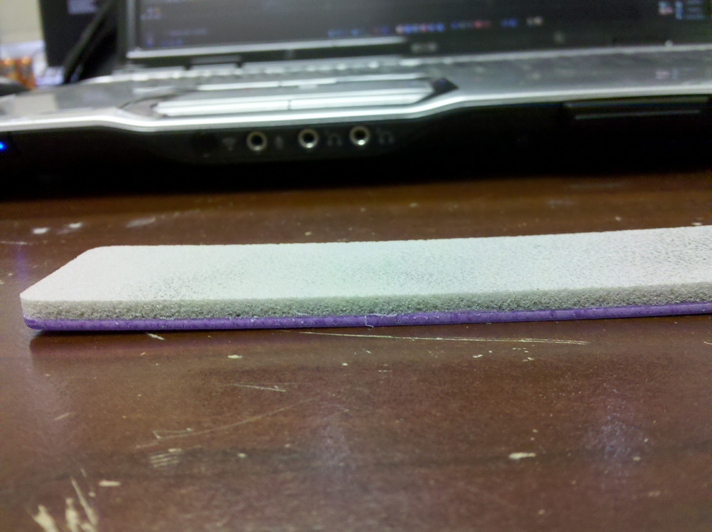

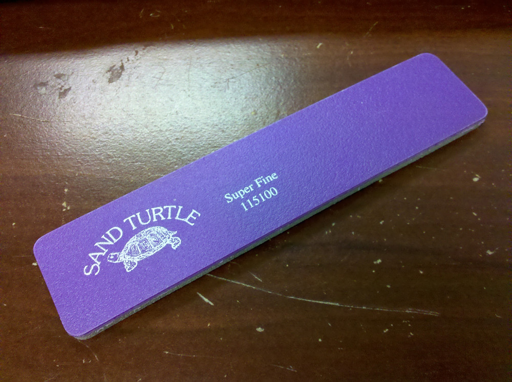

Picked a couple of these up for $1.99 at Sally Beauty Supply this afternoon for my knives. 1 1/8" wide, 5" long, by about 3/16" thick overall. Plastic backed sanding sponge, in approximately somewhere between 320-400 grit. Works very well.

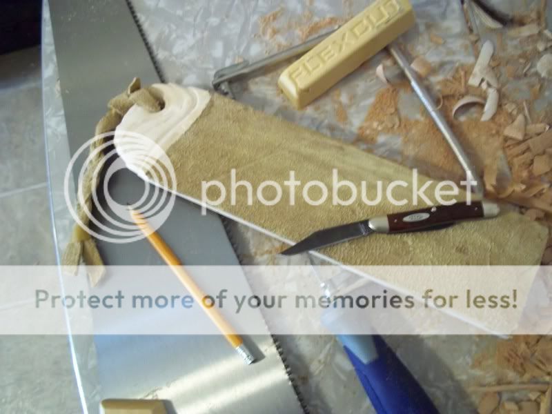

Maybe this weekend, I'll get some strops made up.
Bought the rest of the ingredients the other day.
These work very well indeed. Thanks for the tip. There will be a couple of these in my pack.
