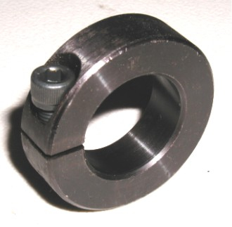

How to fix that?
Pin it
Loctite bearing/sleeve retaining compound
One or more of these - notice that the screw tightens the ring and not just pokes in towards the shaft
Pretty simple - that AND loctite.
