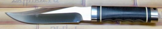

A622D6A0-FE0D-4046-9D18-DA4069030C5B.jpeg The answer is... UNKNOWN. I state this primarily because SOG sells to markets outside of USA, but I can say that I know about the following:
1. S2 "SOG SPECIALTIES" logo on the ricasso, JAPAN stamped on pommel and “SOG SPECIALTIES Santa Monica, CA” on the nylon sheath
2. S2 SOG "Box" logo, “Santa Monica, CA” on nylon sheath w/JAPAN stamped on pommel
3. S2 SOG "Box" logo w/SEKI JAPAN on ricasso, w/nylon and leather sheaths
4. S2B SOG “Box” logo and leather sheath - no country of manufacture stamp
5. Trident 2.0 w/Taiwan on ricasso, various logos and leather sheath
6. S2BR Trident 2.0 w/o finger guard w/Taiwan on ricasso, various logos with an “R” on the ricasso and leather sheath (Sold in Russia and pictured above)
7. SS2 Sterile Trident

2- The Trident 2.0s both far right in your photos as well as the guardless one have clearly different grind lines at
the ricasso from the Hattori made ones which also always used the protruding airplane nut on the pommel. Very interesting to see
the side-by-side difference.
3-That guardless Trident 2.0 clearly is designed to bypass the Russian law which requires utility knives with blades longer than 95mm to have no guard. Pretty weird looking I think but very unique.

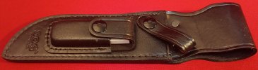

Hey guys, I seem to have a different one. I've had it for at least 10 years. See what you think

Sorry, forgot to mention the sheath says Lynnwood, WA
That looks like the Trident 2.0 as stated on the box, made in Taiwan. Pommel nut is different from the older S1/S2 knives. Handle is slightly canted down from the blade centerline, sheath might be old stock, as I'm sure the Taiwan knives had plastic poppers.
Yup...Taiwan made knife from that pommel nut. Probably 2006-2007 with that "bullet cutter" logo.
That was a cross over period for SOG and for some models they had both Seki Japan and Taiwan
made ones on the market. After that it became all Taiwan made.
