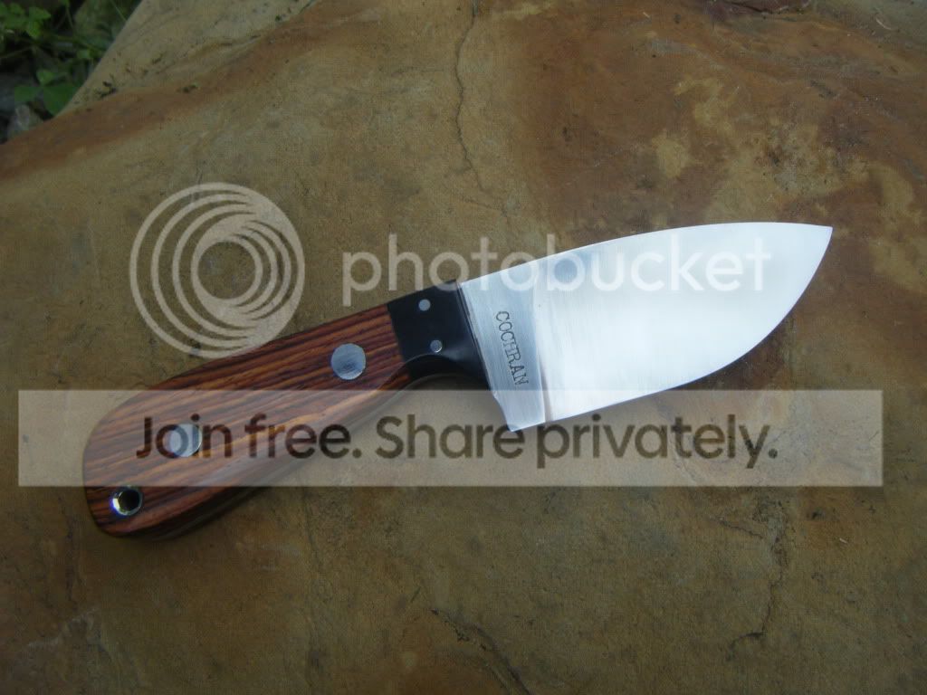

Ok I know Taylor Coleman just did this and got a lot of good feedback. I didnt want to hijack his thread, but being a relatively new maker I would like some input from you guys. So I beg your forgiveness for beating a dead horse:)
I just sold this skinner, you guys tell me what you think it is worth then Ill reveal what I sold it for.
Thanks for the help.
Sean
edit for got some spec.
1080, full flat grind, machine finished 600, cocobolo & black papermicarta
7" OAL
I'd give 50.00 - 75.00 in a show type setting...your work shows promise so I'd give that to bolster you and keep my eye on your work.

Yep. I'd say 60-75, maybe a bit more. Finish looks good, but the handle profile is too square for my taste.
A maker with a reputation might get $150 if everything is spot on. There isn't enough detail in that one pict, but from what I do see it appears you have potential, but that knife isn't quite a masterpiece yet. A spine shot, a measurement of edge thickness and blade hardness, and better lighting on the grind and handle would be more telling.
My guess, without having really seen it or handled it - $80-$100
If the HT or fit up is workable but not exactly great - $40-$60 - but in that case hopefully you wouldn't let it out of your shop.

I guess it was a little unreasonable for me to ask with out some better pics and specs. This was ground from 3/16" 1080, HT was non-magnegnetic then edge quenched triple tempered.
The handle does look a bit blocky in this photo, but it is actually countoured. It finished wicked sharp, I cut thick cardboard until I was too tired to cut anymore, gave it a quick strop and good as new.
Wish I had gotten some better pics, but the first guy I showed it to took it, then ordered another for his son.
BTW I got $100 with a tooled leather sheath. I think that was fair.

It's very difficult to guarantee your work if you are doing a magnet check before quench. That in itself drives the price down. Thermocouples and pyrometers can be found fairly cheap on Ebay. Just a thought.

Not sure I full agree with that, Brook. I know many highend makers who judge by colour, magnets, shadows, etc... I trained by eye using tempilstix (crayons that melt at specific temperatures) as guides. I still recalibrate my eye from time to time... keeping things in check is good.
Consistency is the magic ingredient for quality. Being able to repeat results over and over with little variance. You need to test your work, break blades... tweak your processes to achieve great performance and LOCK IT IN. Metallurgy is VERY predictable with consistency. The romance of knifemaking can co-exsist with modern metallurgy if certain anchor points are in place.

Very true. When I first started out I used a magnet, trying to stay as consistent as possible. I was also using what ever types of steel I could get my hands on. Even with a notebook that I tried to maintain so I could repeat good HTs after countless destructive tests, I still had some variance. I found that with a pyrometer I could accurately control my process.
A good number of the makers who have many years under their belts and simply do it by eye have a level of experience that a newer maker hasn't gained. If a newer maker wants to begin selling blades, I feel they are doing their customers a service by attempting to control their process until they gain the experience to bypass a step or two. This is why I feel it's difficult to guarantee one's work if they are simply using a magnet, unless they are, as Rick indicated, very experienced.

This has been my problem too. Thats why I ordered a PID, I plan on using it with a propane forge for the time being, then later Im going to build an oven.
At least I will be able to somewhat maintain a constant temp. I dont trust my eyes to tell the temp of the steel. It just seems to much like guess work to me. Its been almost impossible to repeat the same HT even using from the same batch of steel. I am looking for a repeatable process. May check out a pyrometer as well. I am only working with basic steels 10xx, 5160 and just a couple of 52100 (which I found out real quick is a picky beast:))
So I figure if I can stay with so called simple steels (e.g. 10xx) and control the process I can nail the HT.
