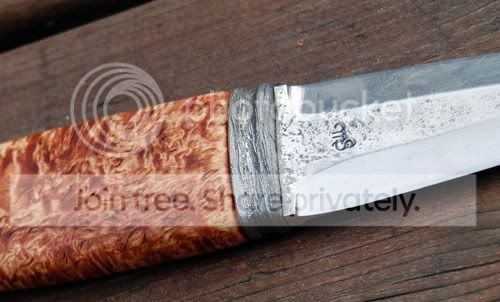

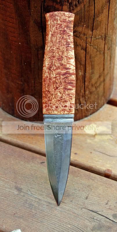

Hello again!
Here are the promised pics of the etched bolster:
I etched it for about four hours in 33% hydrochloric acid and it still isn't as deep as the scrap piece I etched for 25minutes yesterday. I think that is becasue I had heated the acid up pretty much yesterday but couldn't do that today since I was using candlewax as a resist. The candle wax worked really good!
After all I'm very happy with the result.
What do you think?
Regards Jakob

Thank you!
The wood in the handle is curly birch that I've dyed in a brown color. It's not finnished yet, it will dry for a day more and then I will polish the handle with carnaubawax.
I'm pretty sure you would recognize that mark if it wasn't upside down and if it wasn't a forged laminated blade with a quite rough forged finish.
The blade is actually made by Mattias Styrefors. Usually he only makes damascus blades, but I was lucky enough to find this blade by him for sale by another maker:D.
Regards Jakob
