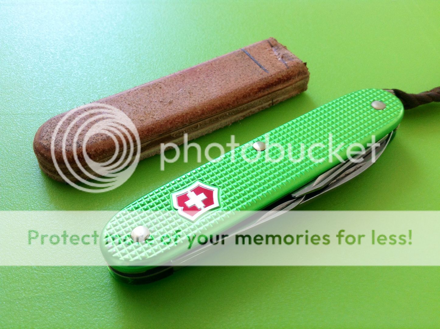

This got me thinking this last week about how to build a folder sheath with the least tools .
It became a bit of a competition with myself to see what was possible with the minimum of tools and when all conventional thoughts and ideas were challenged and some even thrown out the window ..
I actually took photos as I went along so this is a kind of step by step account of making this sheath , it certainly isn't a tutorial and was never meant to be one .
Remember this is an attempt at simplicity .
I started off with a piece of 4-5 oz leather
The sheath will be for one of my SAK's , I have made a number of what I call forms of different thickness which I use for the forming process , but the knife itself would be fine .
The wet forming process begins .
So far I have used a knife , metal ruler and now a bone folder to help with the forming . After the knife pocket is formed I fold the leather over upon itself .
A snap faster is attached , so the tool list now includes a hammer and the anvil and setter for the fastener .
I also cut out a strip of leather which will double side the flap of the sheath .
I skive that strip quickly just with my knife , it is a narrow strip and the skived area will be down inside the sheath .
Time for some glue , so add that to the list of tools .
The whole sheath is now glued together and the excess leather removed .
The wings or flaps of the sheath that create the belt loop are trimmed and wet folded into shape
Snap fastener is attached to the flap and belt loop flaps .
The leather is dyed , so add the dye and a wool dauber to the tool list .
You will have noticed by now that this sheath doesn't have any stitching . Time will tell how this holds together without it but I actually have faith in its durability now that its built , above all else its a bit of fun and also the design of the wrap around belt loop flaps keep everything tensioned and tight , that design was a conscious decision .
Here are all the tools that were used to make the sheath , you will notice an edge bevel tool , it was used so must be included in the list , but it wasn't really necessary .

That's pretty cool bud. I'd take off the beveler and add an awl (or needle if you have a drill press), couple of needles and waxed thread, but that's just me. If you were really on a budget you could sub a stud in place of the snap and setter too. A groover would be nice for the stitches to sit in, but you could also improvise.
The initial outlay for leather, tools and chems really made me consider just buying my sheaths but the mad tinkerer in me just wouldn't allow it. I think it's cool of you to have done this in order to point out that you don't need to spend a small fortune to make fine items out of leather. Not many will be able to match your work straight away, but it's possible with planning and taking some time to do it right.
Good job! ;)
Nice Ken, minimal tools, well done sir. And probably since the knife isn't fighting to get out of the sheath, meaning there isn't any pressure against the glue joints, the glue will most likely not give way.
about the only other thing to do to make something like this without much in the way of tools might be;
Form as you did, but also form a strip to go just a bit below the opening, and also 'form' that so the glued layers of the flap will just fit down into it, and make the flap so it has a spear or arrow head to click in once it gets past the strap, could be just one side has that so it has a kinda of locking method to it.
And on the back side, skive the two sides down and glue them together as well, that much surface area will hold pretty good I think, that way you'd not need the snaps at all.

I wanted to stop in and do kind of a week by week R&D so to say of Ken's stitch-less sheath:thumbup:
I was lucky enough to be the test subject for such a unique sheath. It arrived yesterday and has been on my belt since it's arrival. My belt width is an 1 3/8ths. The sheath fits snug as to not move on me.
The 2 layer Pioneer fits snug but still allows to easily draw and insert the knife in and out of the sheath:thumbup:
I really like this sheath and as I told Ken it rides on the belt without any notice at all. It also frees up my pocket for my Maratac AAA flashlight.
Ken wants a real world review and I'll check back weekly and report my findings good and bad:thumbup: I know Ken mentioned he's very curious to see how this holds up and he stressed to tell it as I see it:thumbup:
I own a Handyman business so I work both in and outdoors, lay on my side, crawl in attics, carry numerous items, bump into everything I try to avoid, so this will get a real day to day WORKOUT:)

Just a quick stop in to update that really not much if anything has changed:thumbup:
The Sheath is used EVERY day, there is NO deformation of the sheath at all:thumbup: Still snug and it's easily keeping it's shape:)
I apologize for the crappy indoor pictures as I worked late and ran out of daylight, in addition to that my cameras Macro setting seems to be going out:confused:
I really really like this sheath and don't see any future issues with this sheath at all;) I do Handyman work and climb in attic's, crawl spaces and lay on my side and figured that would put the most stress on the sheath than anything. It's only been a week but there is NO separation (which was a question Ken had whether or not this would hold without stitching) of the leather AT ALL:thumbup:
This last picture you can just see the top of the Gorilla Tape I used to keep the snap closure from scratching the ALOX:cool:

I meant to update this yesterday but time just didn't allow for it. So Since my last post I applied a leather conditioner---a Silicone/Lanolin Mink Oil I've used for years:thumbup:
There are NO issues at all to this point in time with the sheath, other then a couple of small scuffs due to use. I've become so used to the sheath that pocket carry seems obsolete---but never say never;) Very comfortable and easier to access the knife then in my pocket:thumbup:
