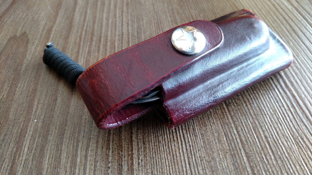

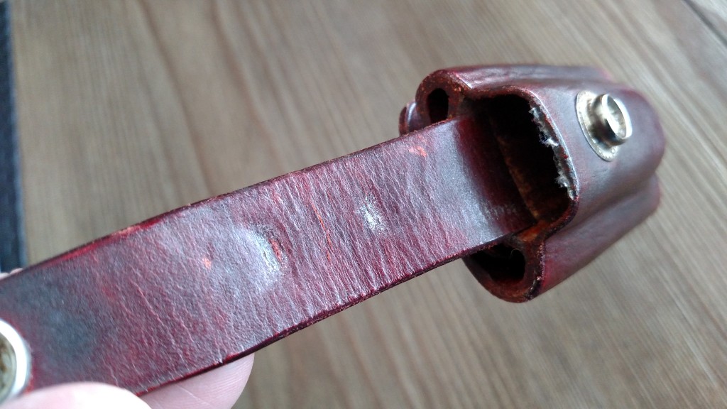

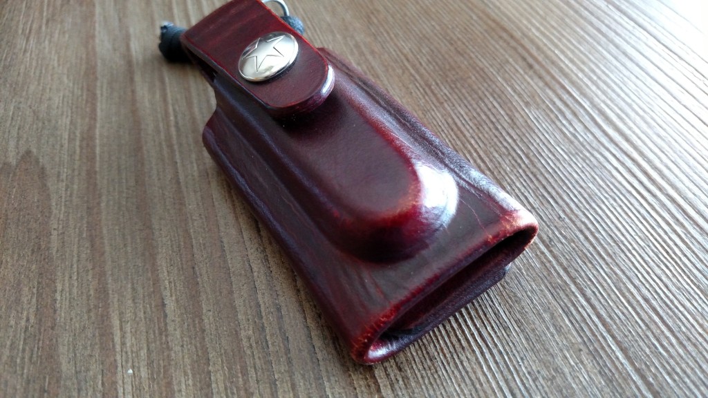

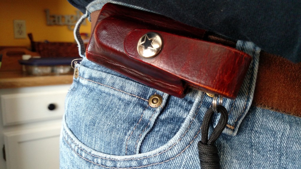

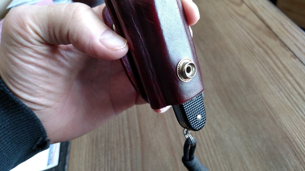

Ok, first off...a major apology to Ken. I guess life got in the way of weekly updates:o
I took my sheath off today to rub in some conditioner and thought of this thread and my failed attempt at weekly updates. Before I applied conditioner (which has been three times since I've owned it) I thought I'd snap a few pics as to its condition.
I wear this EVERYDAY, and I mean EVERYDAY. I'll rotate knives around my edc but this sheath is worn everyday...I did say everyday right:D
The sheath is amazing and has not suffered in any department. Versatility, wearability and super functional. There has been ZERO deformation. It show rubs, scuffs and signs of use but performers flawlessly. The retention remains the same as day one.
THANK YOU Ken, I really appreciate your gift. Now for some pictures...
The fraying you see on the sheath below the snap is just a small piece of Gorilla tape I put inside the sheath so the ALOX doesnt rub.

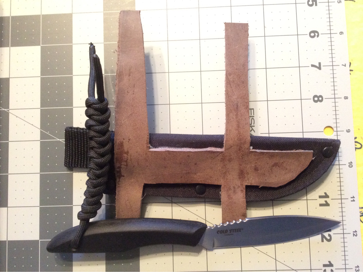

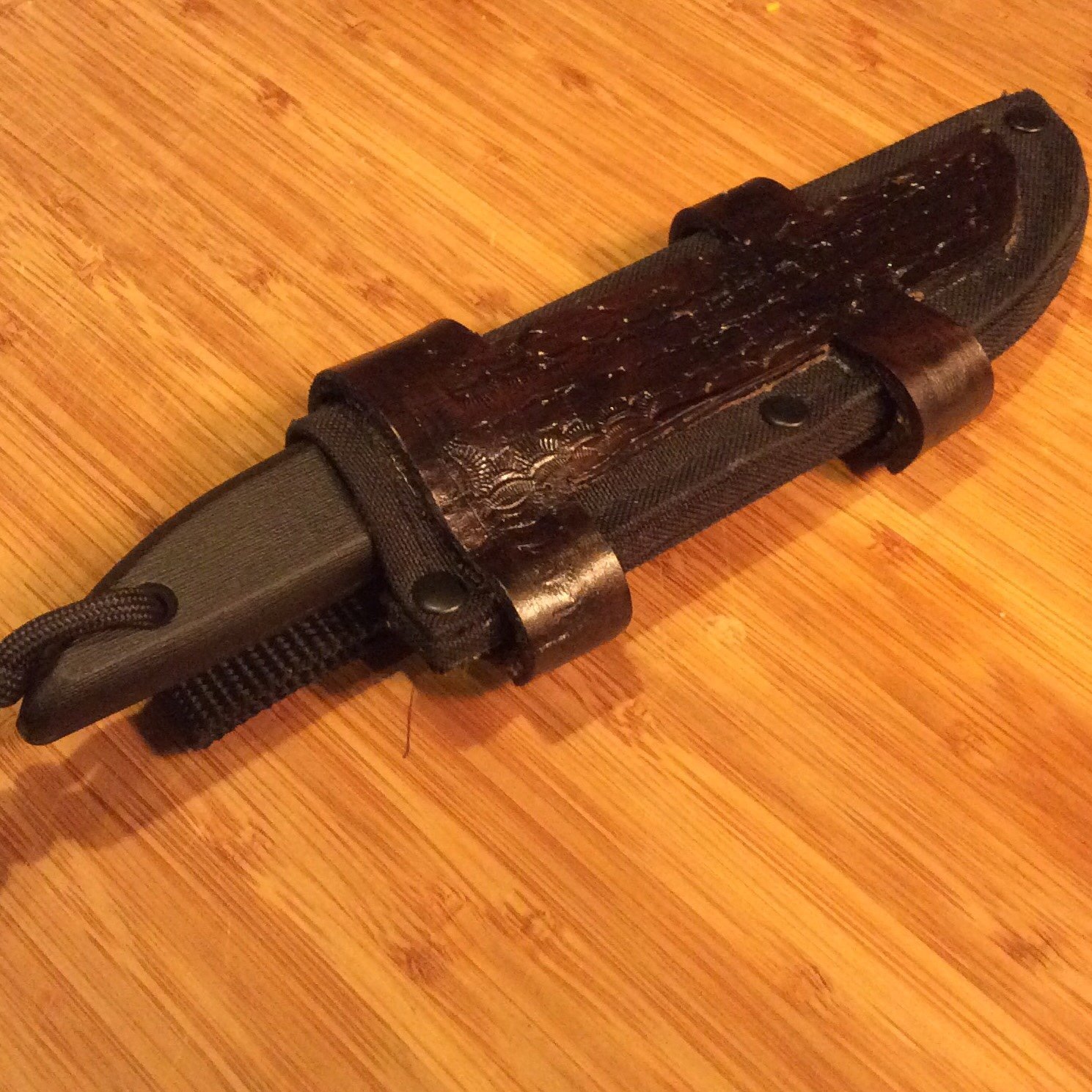

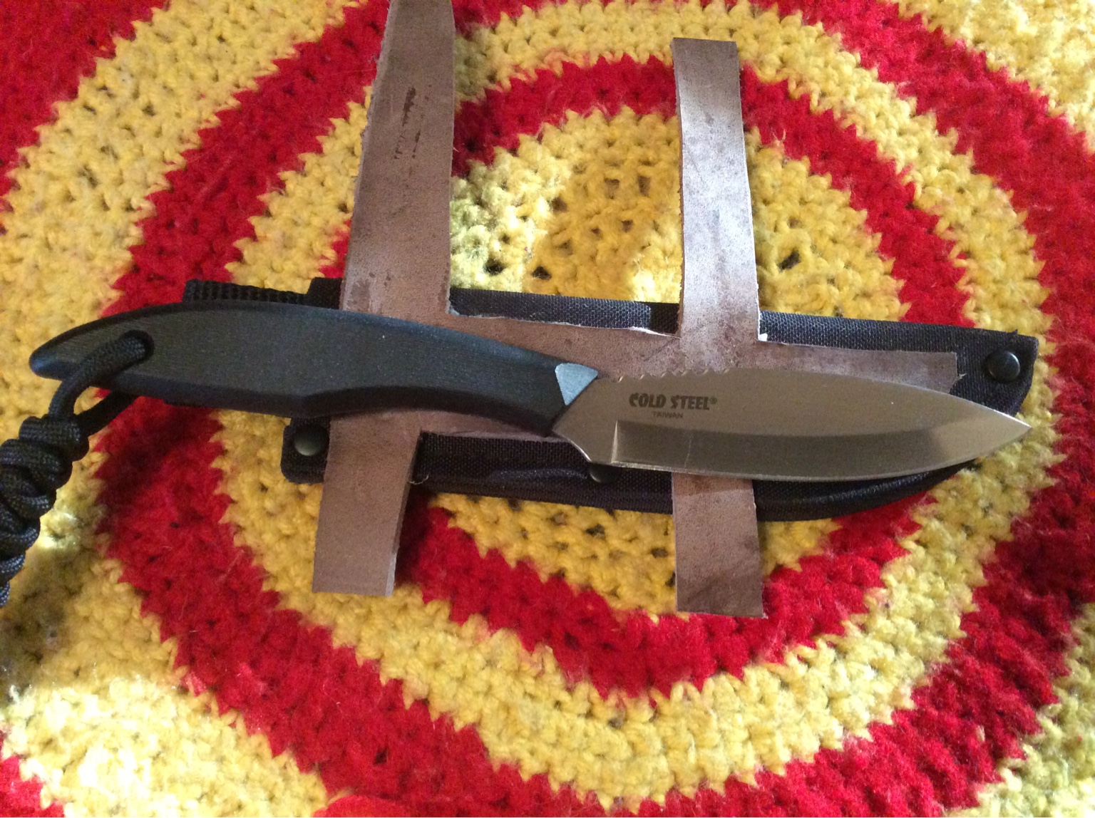

I would use a rubber band to hold this tool together and on the ring, but it hold get old, dirty and break.
Cheap knife I bought just to mod on years ago and a micro light I gave my brother. I used a thin leather biker jacket and glued in a plastic piece (cut from coffee lid) to stiffen it up. He EDC them in his inside pocket on his biker jacket.
^^^awesome idea^^^

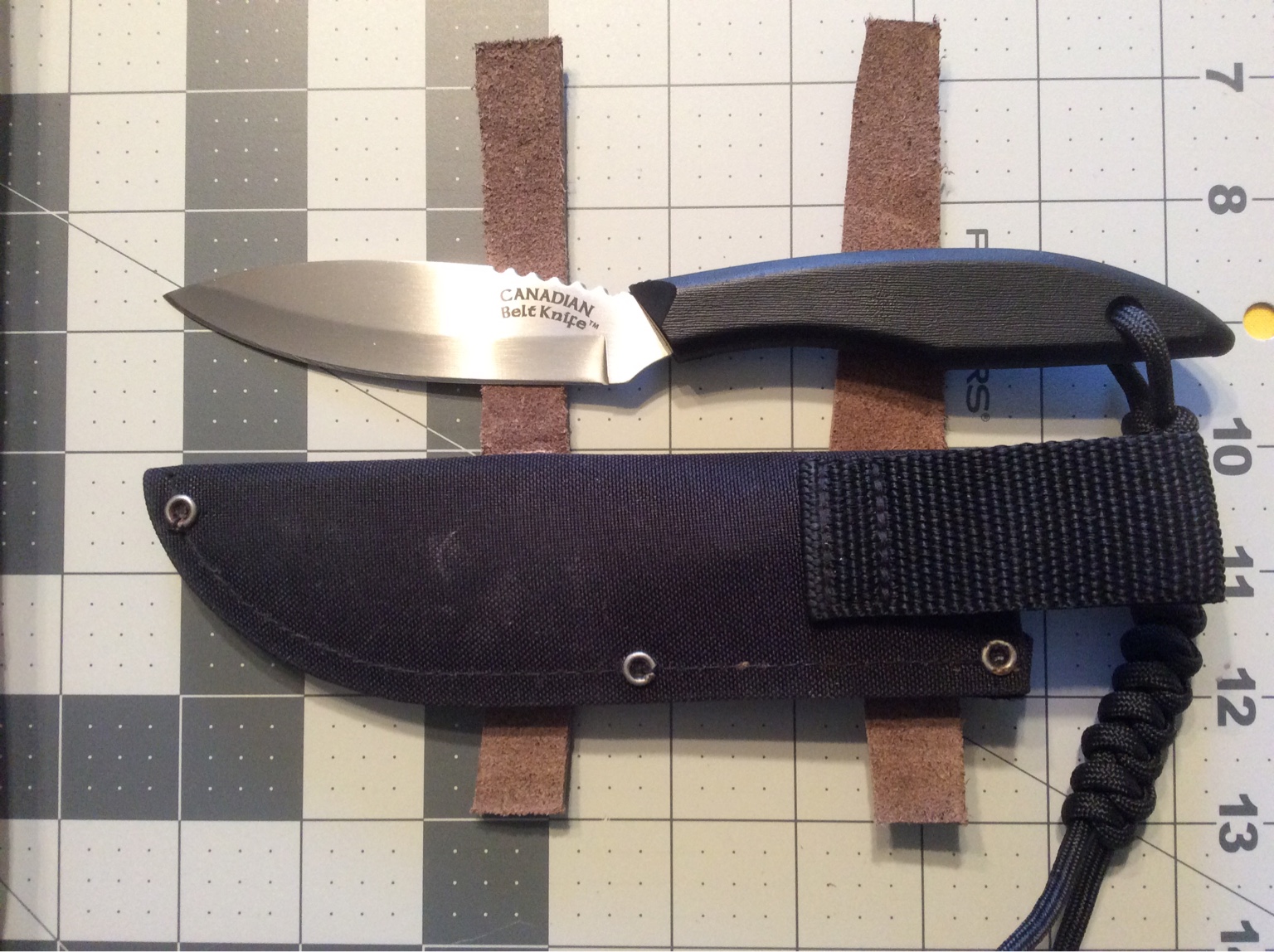

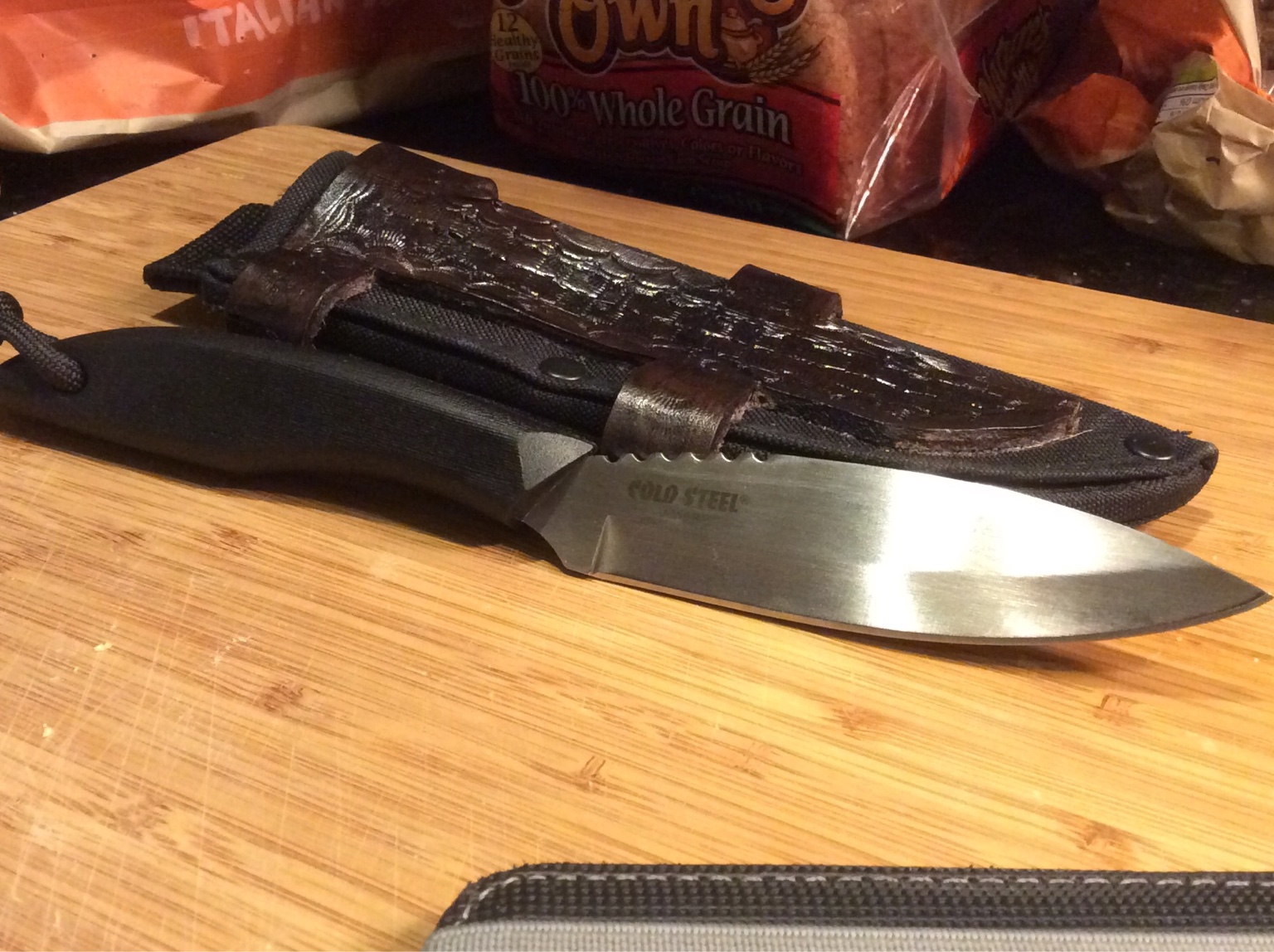

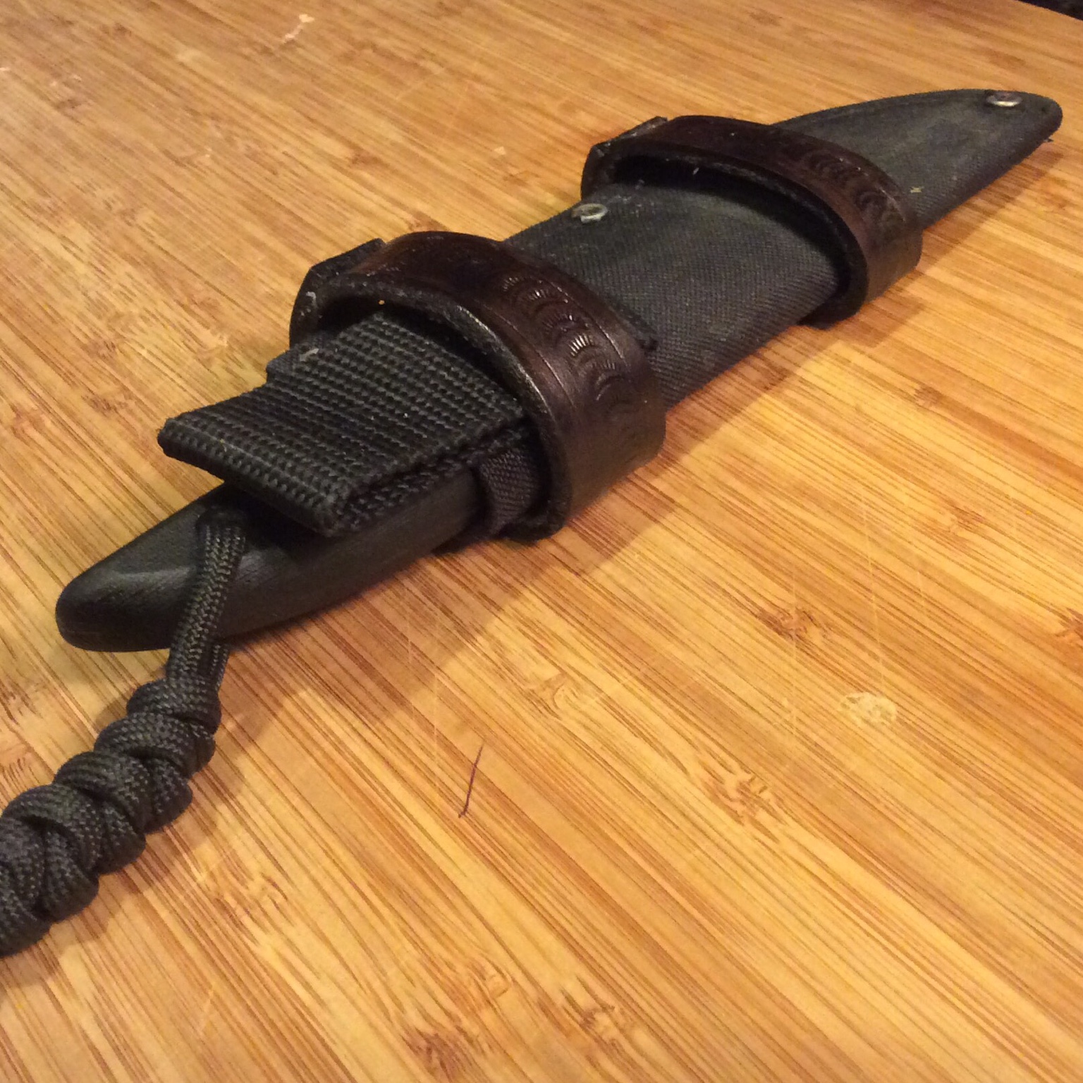

Here I turn a cheap nylon sheath into scout carry. No sewing. It's been working real well. I use that "Wood Weld" glue. No sign of glue failure. After many hours of use so far. Made it with some scrap.
