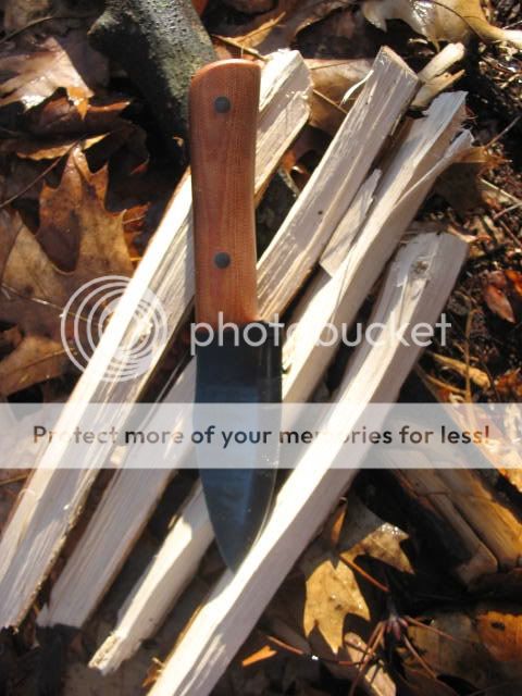

I feel I have plenty of knife with my Koyote LBK at 1/8"....
I think I really started thinking about thinner knives after I discovered Koyote knives and his thoughts on thinner blades posted on his web site. I have several Koyotes, my favorites are my 5 and 6 inch leukus. Nice pic of the LBK.
Jdm61 makes a very good point, the Width of the blade can be a factor too. On my koyote knife in 1/8 or it may even be 3/32, the blade width is about 1 1/4 to 1 1/2 inches wide, giving the blade a little heft. Koyote knives are Scandinvex so there is more steel stock in the blade since the grind starts close to the edge. The heft and the thin stock of the 1/8 should make an effective, not perfect, log splitter. The conclusion is 1/8 steel if configured right can be a very useful blade thickness and handle tough chores. Not my first choice for batoning, but capable in a pinch.

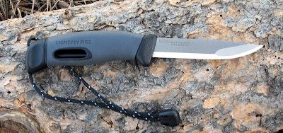

Wood-carving implements must encounter the lateral-stress applied by wandering grains of wood. A hard edge, as mentioned before, resists the forces better than a soft edge, and so can be made thinner, but as those forces increase, the hard edge can fracture if it isn't sufficiently thick, particularly on deep cuts. For this reason, wood-carving blades for deep cuts (knives & chisels) tend to have thicker edges (high edge-angle) but thin stock. This is the standard for puukkos as well. The Mora blade stock is quite thin to be light and cheap, but the scandi-grind is at a very high angle to provide more rigidity at the edge for carving wood, etc. The thicker Mora-Robust, 1/8", would benefit from a full flat grind with a secondary edge bevel rather than the narrow scandi-grind. The Mora LMF knife provides a thinner "relief" grind for improved slicing at the tip, leaving the lower portion of the blade for carving (image from rockymountainbushcraft):
